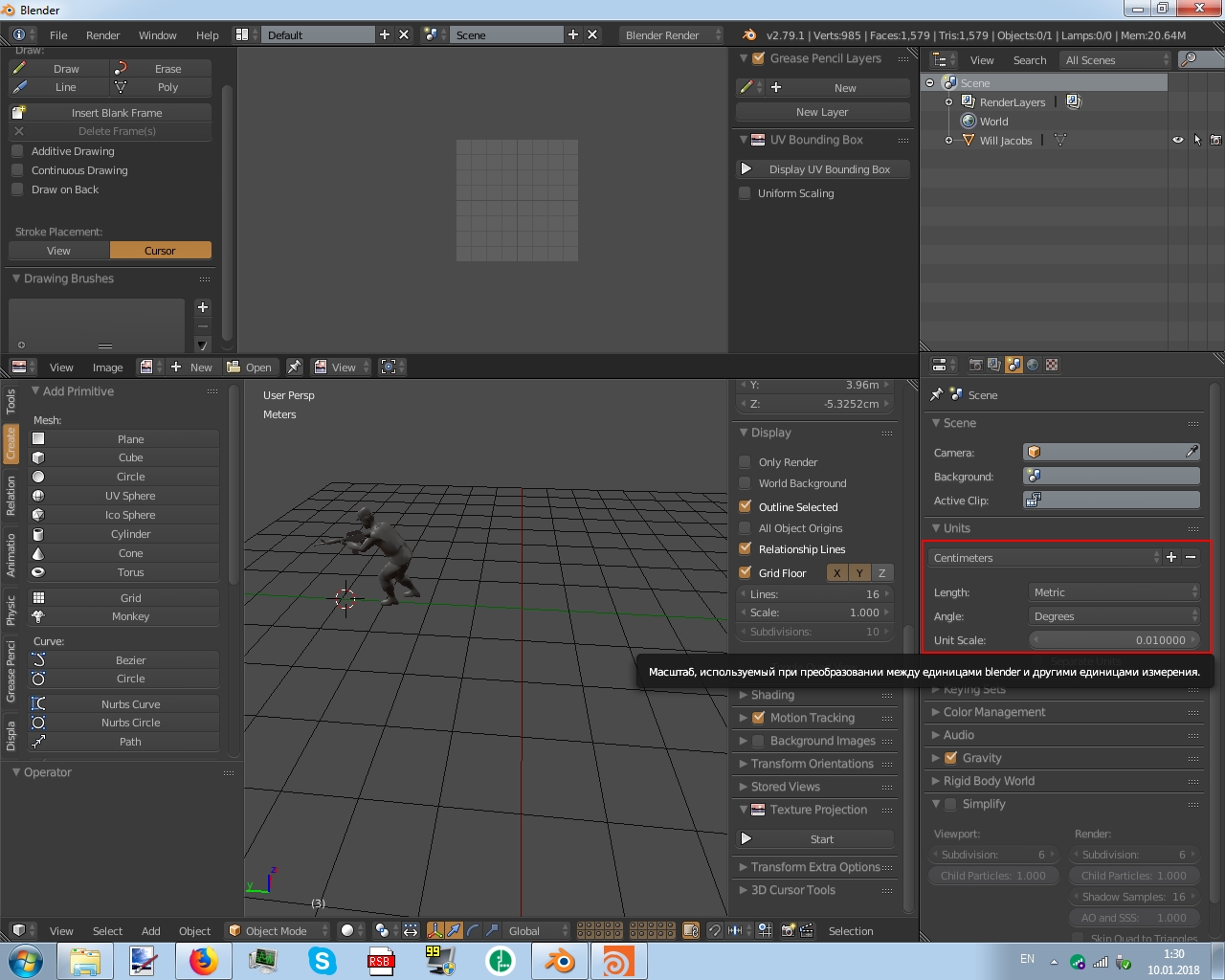

Question 1: how to set the sizes of models? (See for example) So that for example the cube was 1x1x1 cm and not as it is by default unknown in what sizes.

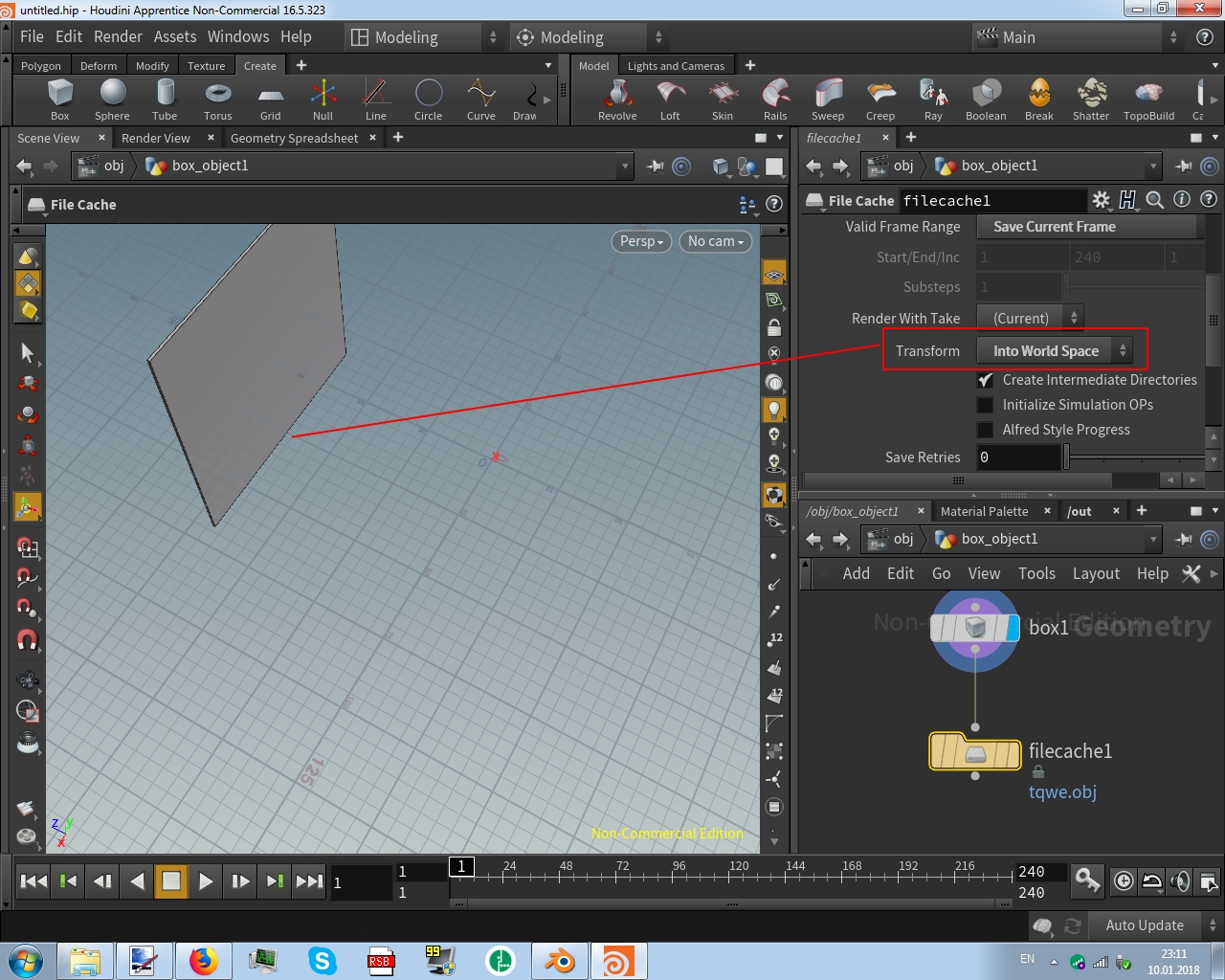

Question 2 on the stage there are 2 objects sphere and torus, how to export them to keep the position and rotation coordinates? This my Screen.

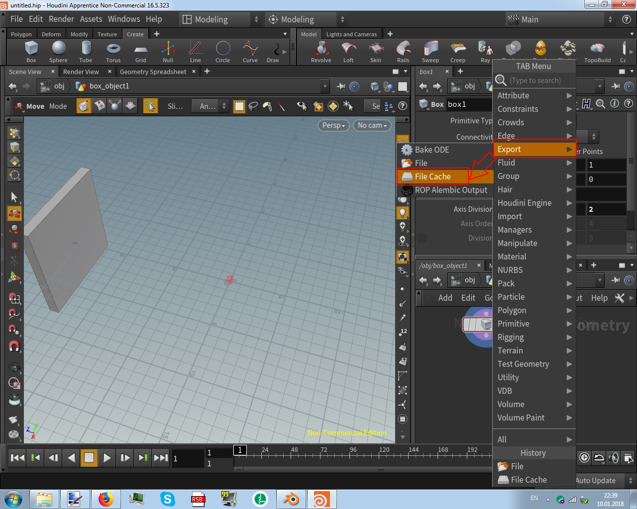

Question 4 when you press Tab there is an export section but the geometry is not exported to the file. How to use it correctly?

1. By the default in Houdini - measurements of length - meters, of mass - kilograms. You can find it in Edit > Preferences > Hip File Options. So any object you create - e.g. your sphere - if you'll dive inside (double click or i key) - has radius 1x1x1 (m). You can change these default values in Hip File Options to whatever you want, but be careful about it - it will influence physically based simulations.
Probably 2. and 3. It seems to me, the better idea is to change Translate/ Rotate/ Scale etc. at the Geometry level (written at the right top corner of your Network) with the Transform node. Can't check it, but try exporting few objects - playing with Merge nodes.
4. And where all see export in the Tab Menu. O_O I thought that RMB > Save Geometry is enough.

This export in Tab.Basically it creates the Geometry node called at the Scene level “file1”. Inside you'll find Surface Operator node called “file_xx” (looks like yellow folder). This is the same node we delete (as you usually see or will see in different tutorials) inside of the default “geo1” node (Scene level) before creating instead of the deleted - e.g. object node for modeling. The File Sop node that looks like yellow folder allows you to e.g. import as were talked about it .obj file > in the Parameters pane > Geometry File field > use Open Floating File Chooser - the next icon to the drop down menu icon.
Also “If its input is connected, you can choose a File Mode to control how the node reads, writes, or caches geometry on disk. If no input is connected, you can specify a geometry file to read in from disk and send through the node’s output.”
In Blender unit 0.01 = 1 cm.Have only Houdini installed, but if you want to have your soldier imported into Houdini and have him human sized, I can suggest to create something like reference (e.g. box), to adjust its height to about for example 2 Houdini Default Units in Y and to resize then your character to the approximately same height. It will be more convenient - if to Ghost Other Objects (icon under the Viewport for Control visibility - looks like tiny sphere, tube and cone with drop down menu).
Do I have to resize my settings every time? After the exit, they are reset to 1 m.As far as I know if you press Accept (not only Apply) - your settings will be saved as the default for this .hip file. Try to save your scene with new options and reopen Houdini. New default units should be in place.
All the same, the position 0 0 0 leaves after export.You'll need to check it, cause I have only Houdini installed, and he reexports geometry to himself with changed values of e.g. Translate and not at the origin of the scene, but probably it's about finishing modeling chain of nodes with the null node, so it's usually treated as the good habit in modeling, and to export it out. Or maybe it's somehow connected with RMB > Make Current Value Default on a parameter you want not be changed of the last node for exporting, or with Lock Parameter.

Houdini's scale is just for Houdini - it has nothing to do with other applications…
inside Houdini the default unit size is 1 Unit = 1 meter
if you model something in Houdini that is 5 Units and then export it to another application it will be imported according to that other application's interpretation of what 1 Unit should be - for example in Maya (default Unit size of 1 Unit = 1 Centimeter) the object will be 5 cm.
If you want to make something in Houdini and them send it to another application then just make a note that you will have to scale - either scale just before you export, or scale just after you import.
