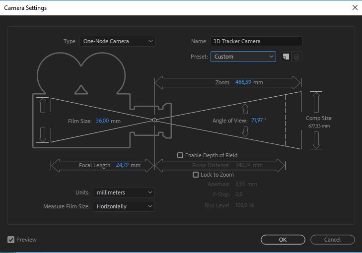

I have done a 3d camera tracking in After effects and exported it using AE3D export script. Once in houdini, I have all the position and rotation keyframes, that's fine. Unfortunately AE3D export doesn't take care of the angle of view. I used to use it with 3dsmax a long time ago, and then all I had to do is match the angle of view in degrees. But I have trouble doing the same with houdini because there is no angle of view parameter.
In houdini's help, it says that “focal length” corresponds to the “zoom” of the camera. But in AE, “zoom” and “focal length” are two different parameters ( see attach image ).
I am a little lost there. ( and pretty bad at math ….)

https://en.wikipedia.org/wiki/Angle_of_view [en.wikipedia.org]
for Angle of view, see the formula 2atan(d/2f)
In the case of houdini camera, d is the horizontal aperture, which is the width of the film back. To go from angle of view, invert the formula to d/2f = tan(theta/2). If you have a particular aperture to use, you can use the ratio to determine the effective focal length.
for instance, assume theta is 80 degrees, aperture is 36mm
d = 36
theta = 80
d/2f = tan(theta/2)
36/2f = tan(80/2)
18/f = tan(40)
18 = 0.84 f
f = 21.45mm

Note that in AE, zoom and focal length and film size are all interlinked. You can ignore the zoom parameter - adjust the other two values and “zoom” will adjust automatically.
