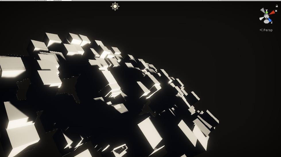

So, i wonder if it's actually possible to use pops right in engine. I mean, there is a time parameter that drives a simulation process, but in case of Unity ( or any other game engine ) it is a bit different. One solution is to have particles cached , but it certainly lacks flexibility. If there was a way to control simulation process with an external parameter instead of time…I think this could make a great tool for spreading things around)

Got it ! Just plug the desired param to the Frame input of Timeshift SOP and there you go ! Awesome)
