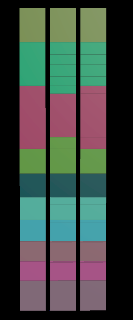

My ultimate goal is to group or name the different prims of the right column, based on how they match the position of the prims of the left column. (Note: you see the columns aside to each other just for debugging purposes. They actually occupy the very same positions, and the points match perfectly)
So I tried to transfer the colors of the prims of the left column to the right one.
I played with the different parameters and different models of the Attribute Transfer node, but I can't manage to perfectly transfer the colors.
Alternatively I could offset one column a bit along its normal, then scatter 1 point for every prim in the right column and throw some rays and get color information of the hit prim… but but… that sounds like too much effort for such simple task.
I've attached my attempt with attribute transfer node, in case you wanna have a look?
cheers and thanks for any help

555 posts
holy guacamole….don't mean to offend anyone here but sometimes…don't get too technical, use your common sense.
The reason the color demarcation is not clearcut is for a large prim, it doesn't take the ‘boundary’ into consideration but it uses the prim centers…so for a very long prim, you might think the color transfer should take place at the boundary but it's comparing the distance to the centroid of the prim and hence the longer prim would have the centroid further away from its target.
So knowing that, without any incredibly complicated technical procedures, I can do with ONE node.
Yeah you heard right, ONE.
All you have to do is after the randColor, add a subdiv>OpenSubdiv Bilinear. Even though Depth of 1 is enough, you might want to make it 2 or 3 to ensure accuracy.
The effect is that your prims are now not very ‘elongated’ and therefore your results are not ‘skewed’.
(also, your Distance Threshold in the attribtransfer seems too high for my liking…i usually go for 0.1 or even less for accuracy…especially now that the geo is subdivved)

Yet another option is to subdivide the source you are transferring from. AttributeTransfer is more accurate when it has more data to sample from.
haha, didn't i say to use subdiv Atom ?
555 posts
here's a better fix…in case you scatter alot of poins (ie. very thin strips)
The fix is, it creates a very thin prim right at the edges,eliminating the ‘elongated’ effect.
This way, you don't have to up the subdiv when you get very thin strips
attrTransfer_fix2.hipnc (118.3 KB)
