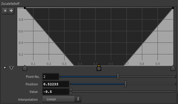

Is there any way to extend the ranges of a ramp parameter in an Attribute Wrangle to go beyond 0 and 1? I can set a point to a value outside the visible range (like -0.5, 2, or anything else), but can't visually grab / adjust the curve because those points lie outside the visible field.

No, you can't change the range displayed by the ramp. If you need to extend the range, consider remapping the output instead.
For example, if you want to make a hill shape that bottoms out at -0.5, draw the shape within the visible bounds of the ramp (0-1), and use the fit function, or add/subtract/multiply to remap the output to the desired range.
If you really need an ‘unbounded’ canvas for your ramp, you can use a channel instead. Any parameter with keyframes can be treated like a ramp using the chf() vex function. Simply pass the input value of the ramp as the time for the channel. e.g. @Cd = chf("curve_parm", @uv.x);

The fit function came to mind, but I didn't realise one could pass it to a channel. Will give it a try, thanks.

When I use ramps and want a greater range I simply use a wrangle to reference the ramp and also create a spare parameter that multiplies the ramp result to give me any end value range.
I also usually use a fit and feed that into the ramp.

if interested, here is an example with some ideas of extending the ramp.
rampfit.hipnc (72.1 KB)

I've just figured out, that the last method didn't use the ramp start.
Here is a fixed version.
rampfitfixed.hipnc (72.2 KB)

Would this be of use to you. Less code. “Shaping” of grid is done more with the ramp itself.
Grid Shaping via Ramp.hipnc (72.7 KB)
