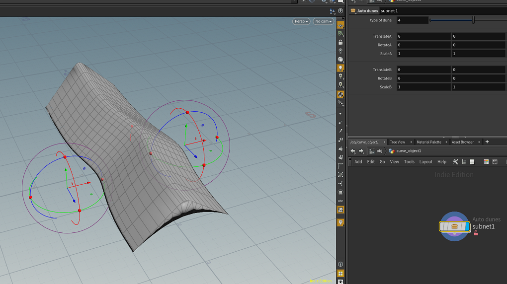

Is there a way of making the transform sop parameters appear in ue4 like we can do it with curves?
I'm making a ‘dune generator’, and while I have the top of the dune made of an editable curve, I would like to move the base edges of this dune with some sort of transform gizmo.
The base are made of other 2 curves that copy the parameters of the first curve (`chs(“../curve2/coords”)`), with the exception that they have a edit node that kinda ‘freezes’ the Ty (so the base stays on the ground).
Since these 2 curves are copying the parameters of the first one, I can't actually make them ‘editable nodes’, since If I do it ue4 will crash every time I try to load the digital asset.
Img of the asset is attached on this post.
