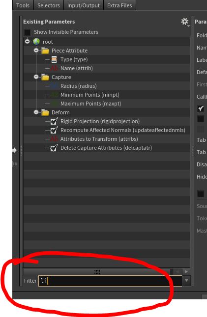

I recently had this problem and found a solution. There might be hidden parameters with the same name on your asset.
Search for them and delete.
In your case search “li”. Hope this helps.

this solution worked for me. Thank you.
