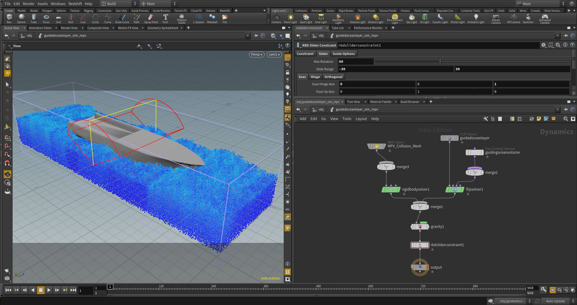

Hi everyone, I'm new to Houdini, so please bear with me .
I'm doing an animation where a vessel is handling some equipment offshore (harsh weather) using a crane.
I am trying to create a first rough simulation only to get the Vessel movement. I'm looking for that natural push of the waves, that would be impossible to accurately create manually.
In real life, the vessel will have a dynamic positioning system, that keeps it “locked” to a position based on realtime communication with satellites.
Of course, it will still be moving up, down (heave) and rotate all axis being pushed by the ocean, but it will not move front, back and sides.
How can I lock the position on X and Y, but keep it free to interact on Z, and rotation on all axis?
Thanks in advance for your time!

Hi and thanks a lot for taking the time to add such detailed explanation.
I did exactly the same steps, the issue is that when simulating, the waves push my vessel away from the initial position.
So I'm struggling to find a way to keep the vessel in the same position (in the world space) during the simulation. Any idea how to do that?
Thanks a lot!

Let's go through the check list
Is your FLIP sim tank animated/moving? If so, you will have to add a force to move the vessel in one direction, against the animation. - I animated it to keep the vessel in the tank. However the vessel was still moving forward too fast, so at a point it was leaving the tank. Anyway, this method is not ok for me, since I will want to have a crane doing stuff, so the vessel must be in the same position at all times.
Is the vessel deformed in any way? Nope
Have you tried changing the density, center of mass or rotational stiffness or any other option in the RBD Solver node? - Yes, no good results.
I have also tried with some RBD Slider constraint. It seems to be working, but as far as I could understand how to set it up, it was keeping only one rotation. I need position on Y, and all rotation axis.
Thanks again!
Thanks again!
