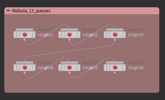

When I click render, it only rendered the last node which called “rslight6”.
It works in mantra and arnold, but not in redshift.
Anyone knows why and how to fix?
Thanks a lot.

Select all your ROPs and
Disable Non-Blocking Current Frame Rendering

Hello I am trying to do the same thing. I cant seem to find “Non-Blocking Current frame Rendering” Where do I need to look?
Joined: July 2018
The “Non-Blocking Current Frame Rendering” option is in the ROP Main tab, near the bottom.
Also, when you running the render outputs, make sure “This Node and All Inputs” is enabled in Render Options. To get to this, go to the bottom ROP in the chain and click the Render flag. A Render options dialog box will pop-up and in the Dependency Rendering Settings you'll see the drop-down mentioned above. Also note that the dependency section will be disabled unless there are other connected ROPs.
Hope this helps.

It worked~! Thanks a lot, man~
