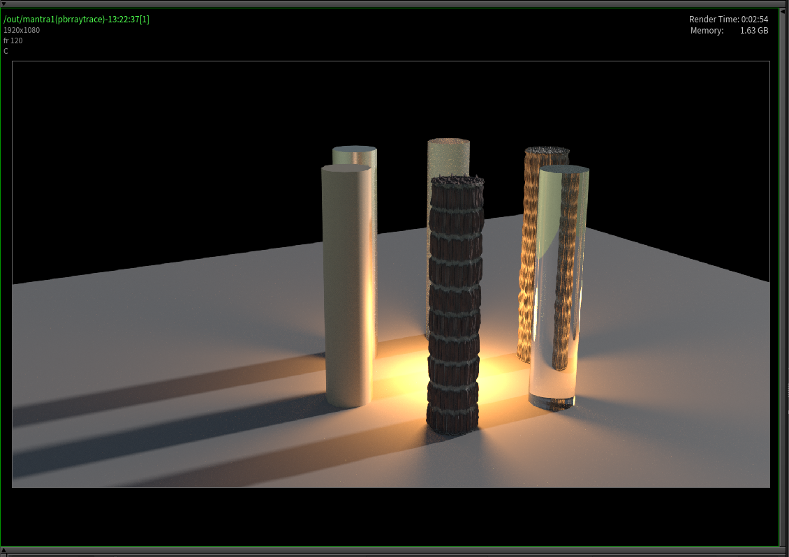

First of all - PC spec: Threadripper 2990wx, 128 Gb memory, GTX titan X. All devices not overclocked. Only stock.
Problem - mantra render work slower when all 32cores (64 threads) is active. But! When active only 16 cores (32 thread) mantra render work faster. 32 cores - 2.54 min, 16 cores 2.11 min. At same time Arnold render, in Maya 2018 update 4, work more predictably. More cores - more speed. 32 cores 1.26 min, 16 cores 2.17 min. Screenshot and test scenes in attach.
UPD. Interesting situation with SMT (simultaneous multithreading) technology. When SMT off with 32 active cores, mantra work much faster - 1.53 min vs 2.54 (SMT on).
When active 16 cores and SMT off - 2.30 min. vs 2.11 min. (SMT on).
Bottom line.
Mantra - 16 core, SMT on - 2.11 min.
Mantra - 16 core, SMT off - 2.30 min.
Mantra - 32 core, SMT on - 2.54 min.
Mantra - 32 core, SMT off - 1.53 min.
And after some tweaks in bios (not direct CPU overclocking)
Mantra - 32 core, SMT on - 2.19 min.
Mantra - 32 core, SMT off - 1.35 min.

There's a few things going on here that affect performance.
First is that SMT is not a doubling of performance. You might get an extra 10% as the 2 threads are able to utilize the CPU better, filling in the idle units of one thread with work from another (maybe). The downside is that a thread also takes memory and memory bandwith, so having twice as many threads means you have less cache to work with per thread - more cache misses, so more higher-latency calls to main memory. And the more misses, the more memory bandwidth each thread is using, and you're already using twice as much.
Second is that a threaded job is made of parts - the threaded part (A), and the single threaded part (B). So if you're looking at total render time, it's
As the number of threads increases from 1, the time taken to do A halves, halves again, etc. Assuming ideal scaling (more on that in a moment), at 32 threads it's taking 3% of the time of 1 thread. And at 64, it's 1.5% (but not really, ‘cause SMT isn’t 2x faster). What happens is that the total time begins approaching time(B), the single threaded stuff. You'll get a nice exponential falloff settling onto some plateau where it doesn't really improve much anymore. This is known as Amdahl's law, and the only way to get around it is to optimize B as much as possible.
The last problem is thread contention. Anything that needs exclusive temporary access to a resource can chip away at the speedup as threads wait. Even getting rid of all exclusive resources in the code will still have waits at the system level. This is a problem which gets worse as the # threads increase as well.
As a user, you can do a few things to fix this. 1) run the optimum number of threads for the job (often needs a bit of testing to determine this). 2) Run multiple mantra jobs with a lower thread count, which reduces the performance loss from the third point (but still runs into performance issues from the first. 3) Disable SMT.
Hope that helps!

I have 2990wx 128gb ram and been using it for about 2 months now, 24/7 sims and rendering. It`s beastly, but not for every user. Windows performance, compared to Linux is much worse, pretty much in every task. I get 10-30% better speeds in pyro/flip/grain etc on Linux Mint compared to win 10. Mantra speed is scaling so much better on linux too.
I have seen absolutely zero speed improvement after Dynamic Local Mode update using Ryzen Master. That goes for benchmarks on sims, or rendering(mantra, vray,corona,)
Now to mantra. Scaling with cores is bad in windows mostly. Pretty much no difference between 32 and 64 cores. And i`ll be bold, lets not blame this on completly on CPU. We know it has its limits on mem bandwidth,latency, and terrible windows scheduler, but that`s it. Other render engines scale much better with this CPU in very same environment, but mantra don`t….
I use vray for 13 years, it scales this CPU pretty much linearly on normal scenes. And with somewhat degraded performance on super heavy scenes(hundreds milions poly + displacements etc).
Small benchmark scene with 6 cylinders like this should not see performance degradation at all. I wish devs can look into this and optimize Mantra for multi NUMA CPUs more, it seems multi NUMA nodes might become the new trend, simple because rising core freq. has become very problematic.
btw, your scene renders on Linux Mint in 55 seconds on my 2990WX at 3.8Gz all cores
