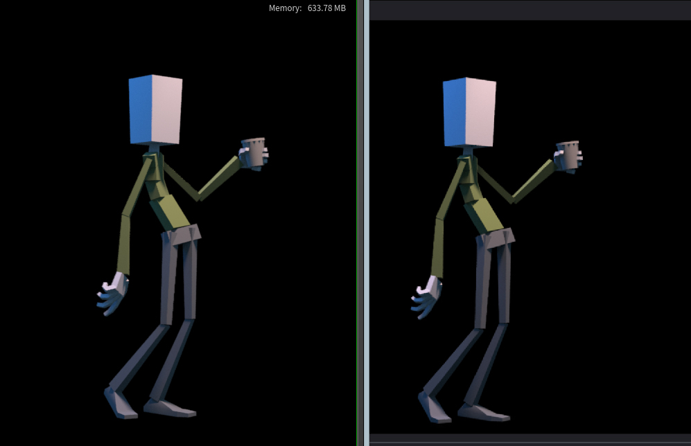

The one on the left is your ROP mantra render, and the one on the right is the Davinci 12.5 with default settings;
With the exception that Gamma is brought up to .22

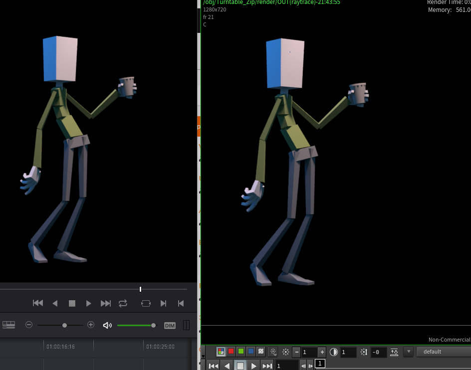

Hey that's awesome, but I'm still doing something wrong
Are there any other places this is set? I tried both approaches but it still looks wrong.
Does this look right? I just made a new project to test it.
Edited by peteski - Oct. 25, 2018 01:04:35
4189 posts
Joined: June 2012
dug into it and it's specific MacOS only setting in Davinci in preferences. See the attached project and screengrab for settings.

522 posts
Joined: Dec. 2013
Woooo! It's working great!
Thanks thanks so much for all the help fuos!
