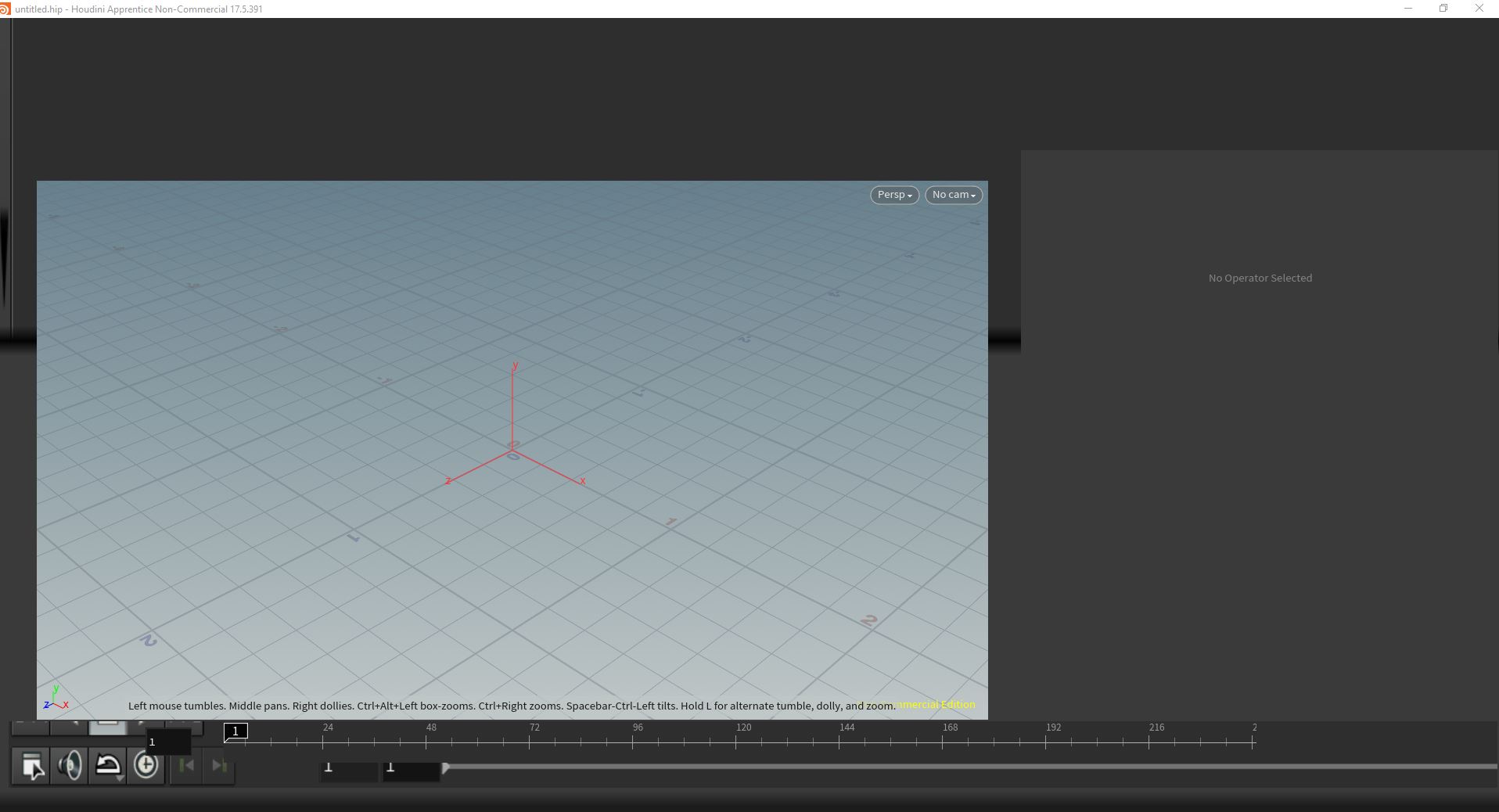

I had the same issue with Intel graphics driver. Problem got resolved by changing the Houdini settings to `High Performance` to use the AMD graphics driver instead:
Before:
Change settings to use AMD graphics rather Intel:
After:
