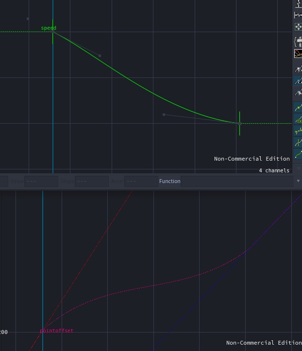

its seems to be behaving correctly,
it needs to go from start to finish of the green curve in the 1st pic.

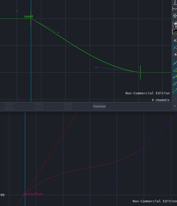

you can fix by changing the speed curve to bezier and editing, 2nd pic.

yeah noodling with that helps.
I'm just trying to R&D something that can speed up and slow down and spread points based on the speed of the sort.
Thank you for checking it out. I really appreciate it.
