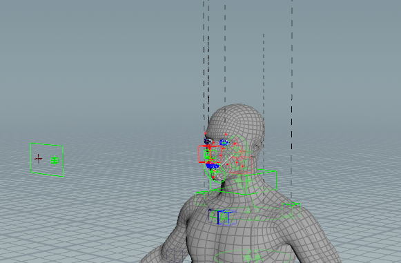

Hey Michael, I wanted to pass you on the project file that I made to show you the error as you mentioned that you couldn't recreate it. I have zipped up my .hip and the low res geo that I am working with. Also, I saved out the JSON files of the auto rig settings one is without the advanced face and the other is with the advanced face… the advanced face gives me this error when I hit generate rig (it does get about 60% finished before the error pops up).
Traceback (most recent call last): File “C:/PROGRA~1/SIDEEF~1/HOUDIN~1.425/houdini/python2.7libs\autorigs\ui\uiCharacterTabs.py”, line 190, in buildRig success = self.currentWidget().buildRig() File “C:/PROGRA~1/SIDEEF~1/HOUDIN~1.425/houdini/python2.7libs\autorigs\ui\uiCharacterTabs.py”, line 343, in buildRig self.autorigs_asset.buildRig() File “C:/PROGRA~1/SIDEEF~1/HOUDIN~1.425/houdini/python2.7libs\autorigs\asset\autoRigsAsset.py”, line 167, in buildRig self.autorigs_modules.buildModules(settings, geoskin) File “C:/PROGRA~1/SIDEEF~1/HOUDIN~1.425/houdini/python2.7libs\autorigs\asset\autoRigsModules.py”, line 101, in buildModules module.buildRig(i) File “C:/PROGRA~1/SIDEEF~1/HOUDIN~1.425/houdini/python2.7libs\autorigs\modules\advancedFace\advancedFaceModule.py”, line 93, in buildRig self.autorigsbuilder.buildRig() File “C:/PROGRA~1/SIDEEF~1/HOUDIN~1.425/houdini/python2.7libs\autorigs\modules\base\autoRigsBaseBuilder.py”, line 61, in buildRig self.buildRigControls() File “C:/PROGRA~1/SIDEEF~1/HOUDIN~1.425/houdini/python2.7libs\autorigs\modules\advancedFace\autoRigsAdvancedFaceBuilder.py”, line 110, in buildRigControls self.eye_builder.buildRigControls() File “C:/PROGRA~1/SIDEEF~1/HOUDIN~1.425/houdini/python2.7libs\autorigs\modules\advancedFace\eye\autoRigsEyeBuilder.py”, line 220, in buildRigControls self.buildRigControlsSide(group1, ismain=True) File “C:/PROGRA~1/SIDEEF~1/HOUDIN~1.425/houdini/python2.7libs\autorigs\modules\advancedFace\eye\autoRigsEyeBuilder.py”, line 317, in buildRigControlsSide self.buildUpperLid(side_group, ismain) File “C:/PROGRA~1/SIDEEF~1/HOUDIN~1.425/houdini/python2.7libs\autorigs\modules\advancedFace\eye\autoRigsEyeBuilder.py”, line 361, in buildUpperLid side_group.getUpperLPCName()) File “C:/PROGRA~1/SIDEEF~1/HOUDIN~1.425/houdini/python2.7libs\autorigs\modules\advancedFace\eye\autoRigsEyeBuilder.py”, line 477, in buildLid loc_null = group.createRoot(self.loc_keys) IndexError: list index out of range Traceback (most recent call last): File “C:/PROGRA~1/SIDEEF~1/HOUDIN~1.425/houdini/python2.7libs\autorigs\ui\uiCharacterTabs.py”, line 190, in buildRig success = self.currentWidget().buildRig() File “C:/PROGRA~1/SIDEEF~1/HOUDIN~1.425/houdini/python2.7libs\autorigs\ui\uiCharacterTabs.py”, line 343, in buildRig self.autorigs_asset.buildRig() File “C:/PROGRA~1/SIDEEF~1/HOUDIN~1.425/houdini/python2.7libs\autorigs\asset\autoRigsAsset.py”, line 167, in buildRig self.autorigs_modules.buildModules(settings, geoskin) File “C:/PROGRA~1/SIDEEF~1/HOUDIN~1.425/houdini/python2.7libs\autorigs\asset\autoRigsModules.py”, line 101, in buildModules module.buildRig(i) File “C:/PROGRA~1/SIDEEF~1/HOUDIN~1.425/houdini/python2.7libs\autorigs\modules\advancedFace\advancedFaceModule.py”, line 93, in buildRig self.autorigsbuilder.buildRig() File “C:/PROGRA~1/SIDEEF~1/HOUDIN~1.425/houdini/python2.7libs\autorigs\modules\base\autoRigsBaseBuilder.py”, line 61, in buildRig self.buildRigControls() File “C:/PROGRA~1/SIDEEF~1/HOUDIN~1.425/houdini/python2.7libs\autorigs\modules\advancedFace\autoRigsAdvancedFaceBuilder.py”, line 110, in buildRigControls self.eye_builder.buildRigControls() File “C:/PROGRA~1/SIDEEF~1/HOUDIN~1.425/houdini/python2.7libs\autorigs\modules\advancedFace\eye\autoRigsEyeBuilder.py”, line 220, in buildRigControls self.buildRigControlsSide(group1, ismain=True) File “C:/PROGRA~1/SIDEEF~1/HOUDIN~1.425/houdini/python2.7libs\autorigs\modules\advancedFace\eye\autoRigsEyeBuilder.py”, line 317, in buildRigControlsSide self.buildUpperLid(side_group, ismain) File “C:/PROGRA~1/SIDEEF~1/HOUDIN~1.425/houdini/python2.7libs\autorigs\modules\advancedFace\eye\autoRigsEyeBuilder.py”, line 361, in buildUpperLid side_group.getUpperLPCName()) File “C:/PROGRA~1/SIDEEF~1/HOUDIN~1.425/houdini/python2.7libs\autorigs\modules\advancedFace\eye\autoRigsEyeBuilder.py”, line 477, in buildLid loc_null = group.createRoot(self.loc_keys) IndexError: list index out of range
The JSON File without the face builds and seems to work. Please let me know if you see a solution on your end. thanks for taking the time to look into this.
I did see those dotted lines but I had no idea what those were. I thought they were somthing for placing the controls in the right spots. Are you getting the rig to finish generating? Did you just load up the json file and hit generate? I thought I unchecked the tongue as there is no need for those bones. Please let me know what you find out. Thanks Michael.
