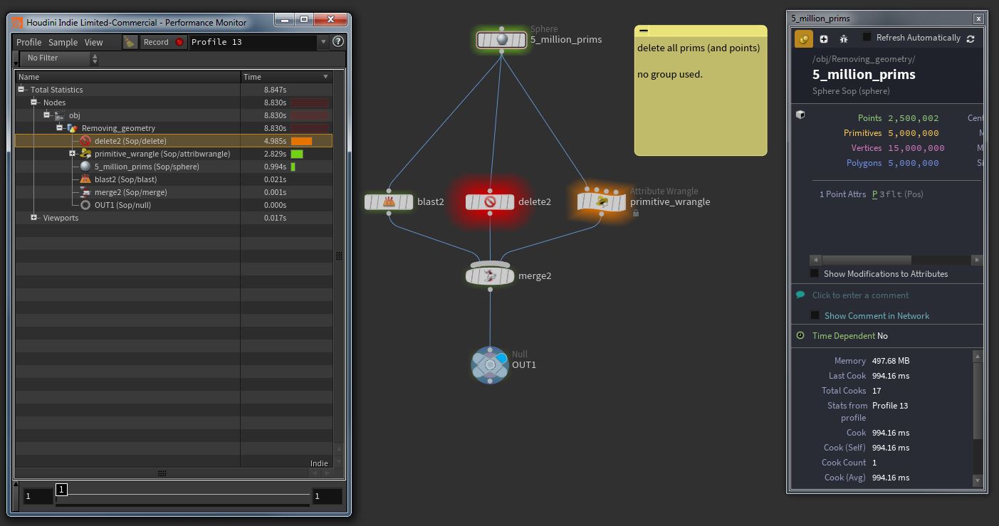

I've not tested it with groups, which would be a more real world scenario, so measurements might vary, anyway…
for deleting all the prims, we're talking about more than hundred of times slower than the blast node.
For deleting all the points it's even worse. I wonder if I did anything wrong with the performance monitor ahaha
Would be worth to measure it with groups and deleting only a portion of the geo.
Anyway, I was totally not aware about the big performance difference of the wrangle node in respect to the blast node. Thanks for pointing that out!
