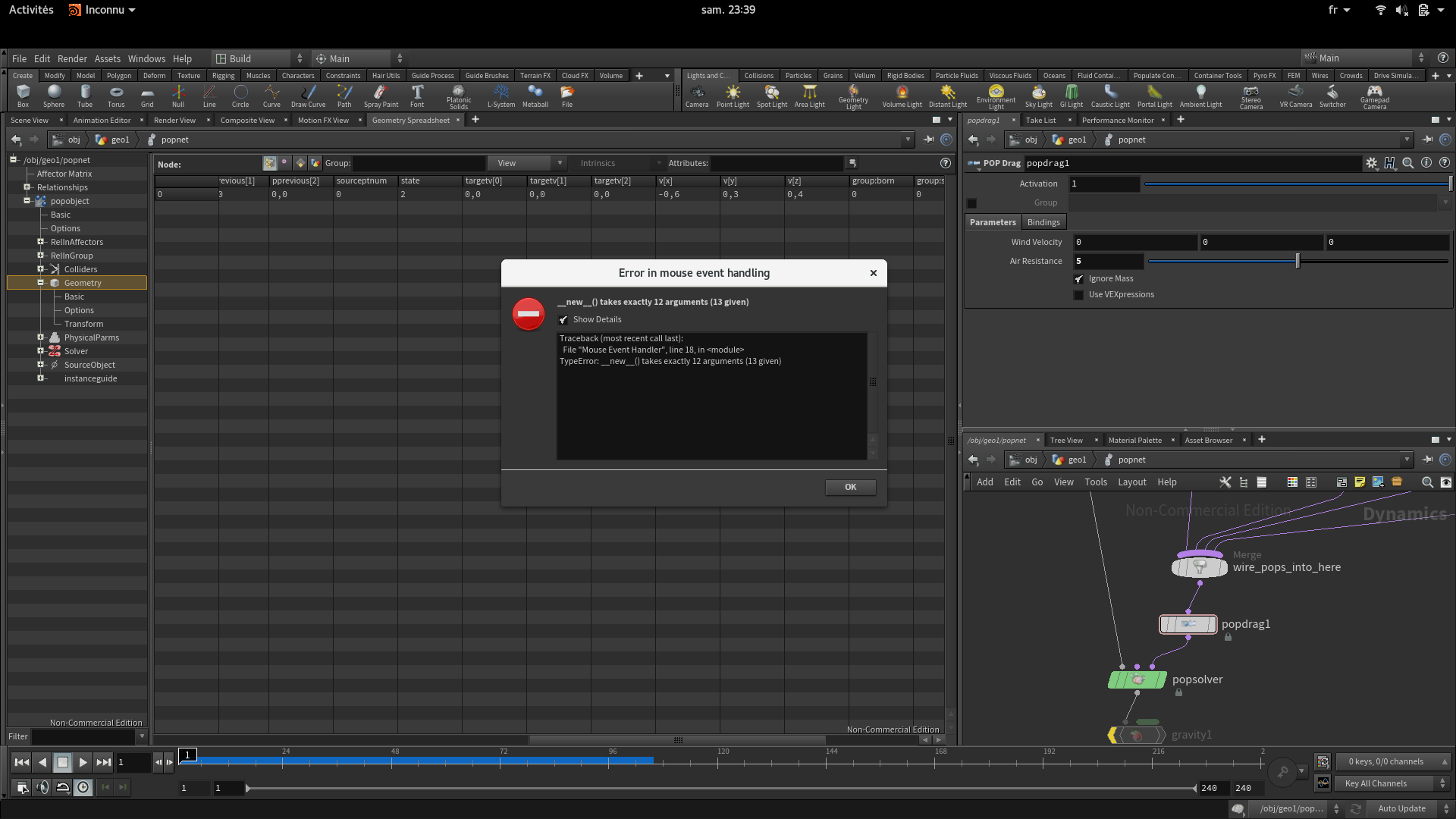

I am getting this error every time I try to access the Houdini help after that if I move the mouse anywhere inside houdini I got locked up by this message.
Anyone else by any chance is also having the same issue?
Error in mouse event handling in centos 7.6

More details, that is what the console prints back:

And a screenshot of the error.
Any tips of may be causing it?

In case anyone else have this problem, this is what Sidefx told me to do and it helped:
Please try setting the environment variable:
LC_ALL=en_US.UTF-8
In your $HOME/houdini.env file.
If that does not work, please try setting the following ones as well:
LC_MEASUREMENT=en_US.UTF-8
LC_NUMERIC=en_US.UTF-8
I hope it helps someone.
