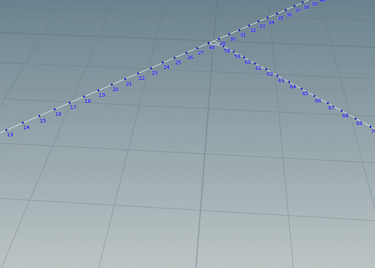

I'm experimenting with creating weblike structures with vellum hair and am getting strange results when setting restlength scale < 1. I've attached a really simple example.
If the scale is 1, everything behaves like expected, however if it's smaller, points seem to move towards each other rather than stretching evenly. I guess I have a misunderstanding of how this should work
Thanks for any hints!

To answer my own question, all I needed here is a Distance along edges constraint. That works as expected!
