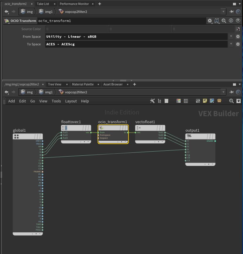

Solved it! For anyone who might have the same problem:
VOP COP2 filter can do the job.
For sRGB images either linearize in the file node or use Utility-sRGB-Texture as “from space” in the ocio_transform. (not sure which one is better)
Now just need to automate it a bit with python..

Thanks for the post, I had the same issue in one of my projects, the only thing to watch out is that Utility-Linear-sRGB is the preset for Linear images, if you use texture in 8bit or 16 bit, you will need use preset Utility-sRGB-Texture
source https://cgrenderdna.blogspot.com/2018/06/how-to-use-acescg-in-arnold-for-houdini.html [cgrenderdna.blogspot.com]

thanks for this post,
i've made my testings on my side,
In the case of an 8 bit srgb image file
in the file node in cop check linearise non linear images,
this will make your 8bit a 16bit / then do a vopcop2filter
> Utility - Linear - sRGB conversion to ACES - ACEScg : just as previously mentioned.
If you don't linearise what happens is that your 8bit stays 8bit,
so for example if you try to put a gamma correct node after the conversion,
colors will be clamped and saturation will touch the sky > not be relevant anymore.
(That's what may happen if an intense light is close to this texture).
If you don't want to linearise, put your file node then a convert node
to convert 16 bit then apply the conversion to acescg as previously mentioned.
( Or make your own by down “fstopping” + up ‘fstopping" the duplicated file manually
and then do a fusion hdr in photoshop, that may help to fake the 16-32 bit look
with an 8bit file but that’s out of topic).
Hope it helps,
Hope it helps,
