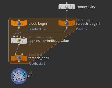

I have now a similar issue, but this time with a normal for loop (non-vop context).
I'm iterating over connected pieces and I want to populate an array with the number of primitives for each connected piece.
the code I'm using in the wrangle is the following:
append(i[]@store_nprims , nprimitives(1));

67 posts
Andr
But still, the curiosity on how to make it work with a sop for-loop remains
This way works, by using a Block Begin set to Fetch Feedback.
Edited by pabcou - June 16, 2019 15:36:57
