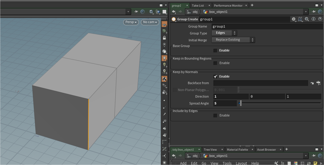

Also, is there any way to specifically-identify the normals for the edges as well? (i.e. NE/SE/NW/SW)
Use the Keep by Normals option in the Group Create SOP. See image for example.
The options under the Include by Edges section like Min/Max Edge Angle and Unshared Edges will probably also be of interest. Also remember that you are able to composite groups with Group Combine, which will probably be necessary for a lot of what you want to do. The ability to promote groups (ex: points to edges) is also very handy.
