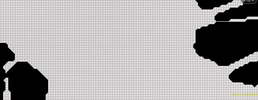

I'm trying to connect only adjacent primitives.
But,I don't know how to do.
If you have idea ,could you tell me?

27 posts
Joined: Oct. 2018
I tried DIvide node.
But the result is a crazy geometry.
Why is this?
You can use any method, please tell me the solution.
I set the path of the image named “number-14-gray” here.
HowRemoveSharedEdges.hipnc (167.4 KB)
686 posts
Joined: Sept. 2013
You would usually use the trace SOP for this:
http://www.sidefx.com/docs/houdini/nodes/sop/trace.html [www.sidefx.com]
27 posts
Joined: Oct. 2018
Konstantin Magnus
I tried it,but it is very slow
