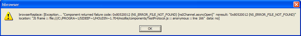

I got the following error message when trying to lookup the help on shopnet (see snapshot). That happens in both 8.1.704 and 8.1.666.

Yes, I have Java installed. It complains only for certain nodes like null, shopnet and ropnet. In most other cases it works well. Seems like it's looking for nonexisting HTML files - …/helpcards/shop/shopnet.html and …/helpcards/out/ropnet.html
In the case of null, I noticed that it's looking for …/helpcards/obj/null.html, but the actual help file is called …/helpcards/obj/obj.null.html, so I made a copy of that file and renamed it null.html
For shopnet and ropnet - i don't see anything in the /shop and /out folders that resembles their help files.

I get :
content/helpcards/shop/shopnet.html cannot be found
(I checked … the shopnet.html file really is NOT there).
And then in the console :
error: Could not communicate to run Javascript
(WinXP 8.1.746)

There are a few helpcards like this that are mis-specified. If you poke around in the distribution, you can usually find the correct location, and then point the help browser to that.
