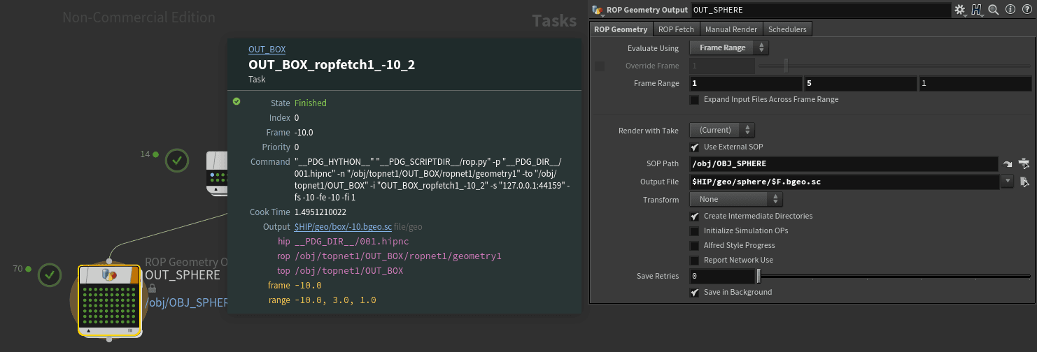

I have a PDG network work I am generating 5 work items from a @wedge attribute using a wedge top node. I am then running a sim to wedge the emission of the source, from frames 1-100. I then want to do another post operation from those results (for example, blurring the volume), per using my original @wedge attribute. I can use the `@pdg_input` variable inside of the file node to pick up the sim from the corresponding work item, and it all works fine.
However, when I set the frame range for my 2nd step (blurring post operation) for the 1-100 frame range, I get 50,000 new work items for that second step (because it is taking my orignal frames (5 wedges*100 frames), and doing that for 100 frames again for the next step). However, I only want 100 work items per wedge index, since I am only picking up the resulting frames from my original sim.
I have tried a number of things, including isolating the first frame of each wedge and then stepping through the sim with a @frame attribute in a file sop, but it still sticks to that first frame and does not run through the whole sim.
I know this might sound a big confusing, and I can do a hip file when I get home, but I was wondering if someone could lead me into the right direction off the bat. I was trying to use parition top nodes to group my original @wedge work intems into single work items after my initial pyro sim, but with no success.

Hi Tyler,
It sounds like for your second step, at the very least you should be setting the “evaluate using” parameter to “single frame” instead of “frame range”. If for your blurring operation you need to have multiple upstream frames, then consider a partition by frame node. You shouldn't need mappers for this (mappers are an advanced topic, that mostly applies to tying together two procedural chains, such as for example handling some manual edits on top of an existing procedural chain. we'll have tutorials around it in the future once people get more used to using partitioners).

Hi Tyler,
I took a quick look at your file. While I may not know for sure whether what I see is causing the problem, I did notice at least a few problems:
1) The wedge node is creating 5 wedges on a integer attribute from 0 - 1. This means that 2/5 wedges will have a value of 0, and 3/5 wedges will have the value of 1. So for all intents and purposes, there are 2 wedges, and not 5.
2) The Blur_FrameRange node appears to be pointing at the wrong part of the network - it is pointing to the original sim and not the blur part of the network.
3) I looked around and saw no mention of @wedge (the name of the wedge attribute being created in the beginning) being used any where in the DOP or SOP network. Maybe I missed something, but unless that is actually used in those networks, there will be no variation.

Thanks for taking a look at it.
1) Yes this was a mistake. Fixed.
2) Fixed
3) Its in my noise offset of my emitter. I am not really going for a something amazing I am just trying to figure out this partitioning.
I uploaded the scene with the fixes, but am not getting the 5 wegded blurred results of the sim that I am looking for (only getting one of them). Thanks for your help.
2) Fixed

Ok, here is the problem - the blur part of the network is something that only accepts 1 of 5 inputs. A single file sop can only read 1 of the 5 upstream images. In order to blur all 5 images, you'll need something that has 5 file sops (or a single file merge sop), each being set to `@pdg_input.0`, `@pdg_input.1`, `@pdg_input.2` …etc. The the rest of your sop network will need properly blend those together.

Thanks for the clafication, I never knew you could do `@pdg_input.1`. However, I am trying to set up work items for them individually, so I get 5 sets of 1-100 frames, each outputting the blurred result of the incoming sim. I am sorry for not making that clearer.

If you just want to run a sim again for each wedge, you can use a partitionbyattribute for the wedgeindex value and then generate new simulations from each of those partitions.
Thank you for the help, but it looks like the Blur process is only getting the first frame of the Sim step, even though the frame attribute is picking up the current frame…

Tyler Britton2
Yes, sorry that wasn't quite right. If you look at the Output files on one of the partitions in partitionbyattribute1 you'll see that all the wedge frames are there, because the outputs have been merged. Since the expression on the File SOP is `@pdg_input`, it always reads the first element in that list of inputs, which is always element 0 (frame 1).
There are two ways to fix this:
1. Change the File expression to use the correct element of the list ($F-1): `pdginput($F-1, “”, 1)`
Or
2. On Blur_FrameRange, set the Expand Input Files Across Frame Range toggle. This means the input list of each work item will be set to only one of the elements from the partition's outputs, and so your original expression will work.
Edited by chrisgreb - May 13, 2019 14:39:36

Hey Chris, I tried both of those, and the #1 is erroring on the expression, and the Expand Input Files solution for #2 is still only bringing in the first frames. I am working in 17.5.173, could that be why?
