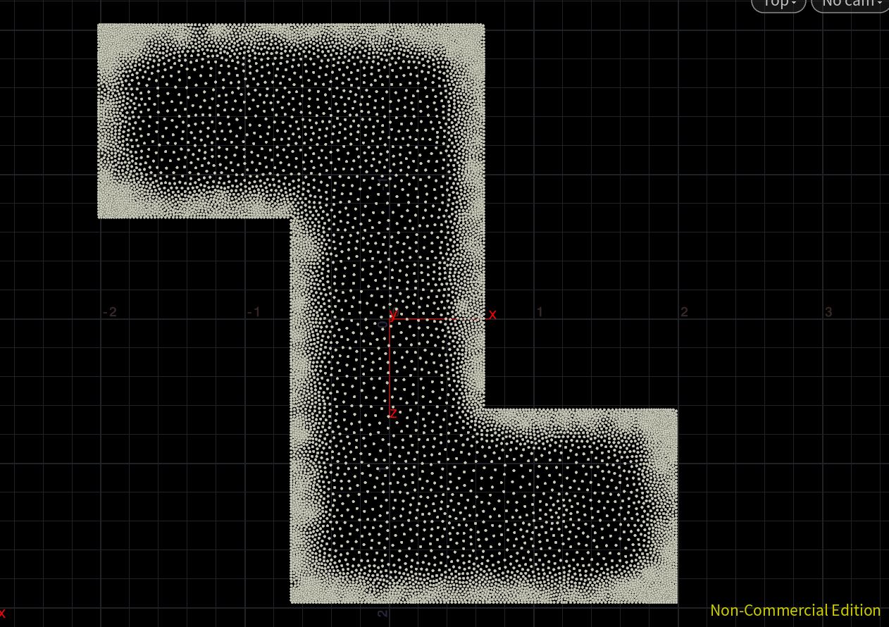

Scatter points on surface with falloff density near the edge
4052 5 1- artmklgnv
- Joined: July 2019
- Aizatulin
- 495 posts
you can use the xyzdist() function to measure the shortest distance from any point of the surface to the border. After this you can use a ramp for example to set the @density attribute, which can be used in the scatter node. Make sure that you have enough surface points (for scatter).

Maybe less efficient than Aizatulin's solution, but a code-less approach is to use a falloff node.
Have a look at the example file (play with the parms in the colored node to change the effect)

NicTanghe
Annyone know how to do this with volumes ?
If you have an SDF, you can use it to remap density using a ramp:
float density = fit ( @surface, ch("min"), ch("max"), 0, 1 ); @density = chramp("density", density);
