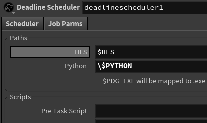

Hi. Adding to this thread. I am trying to render USD from PDG.
The jobs are going through to deadline but am getting this error. I can use the command line to render in deadline fine. Just not submit jobs through PDG. Has anyone had any experience with this? Best Mark

2020-12-15 21:44:37: 0: INFO: Setting Process Environment Variable PYTHON to

2020-12-15 21:44:37: 0: INFO: Task Executable: python.exe
2020-12-15 21:44:37: 0: INFO: Task Arguments: "E:/UH_construction_2021/UH_projects/deadlineTest/pdgtemp/12676/scripts/usdrender.py" "--hfs" "C:/PROGRA~1/SIDEEF~1/HOUDIN~1.426"
2020-12-15 21:44:37: 0: INFO: Invoking: Run Process
2020-12-15 21:44:37: 0: INFO: File "python.exe" is not rooted, checking current directory
2020-12-15 21:44:37: 0: INFO: File "python.exe" is not rooted and is not in the current directory, checking PATH
2020-12-15 21:44:37: 0: INFO: File "python.exe" is not rooted, is not in the current directory, and does not exist in PATH
2020-12-15 21:44:37: 0: Done executing plugin command of type 'Render Task'

With that path mapping, try setting the Python Job Parm on Deadline Scheduler TOP to \$PYTHON instead.
Edited by chrisgreb - Dec. 15, 2020 17:38:27
704 posts
Joined: Aug. 2013
Hi Chris
That worked perfectly. Thank you, and have a great Christmas! Best Mark
