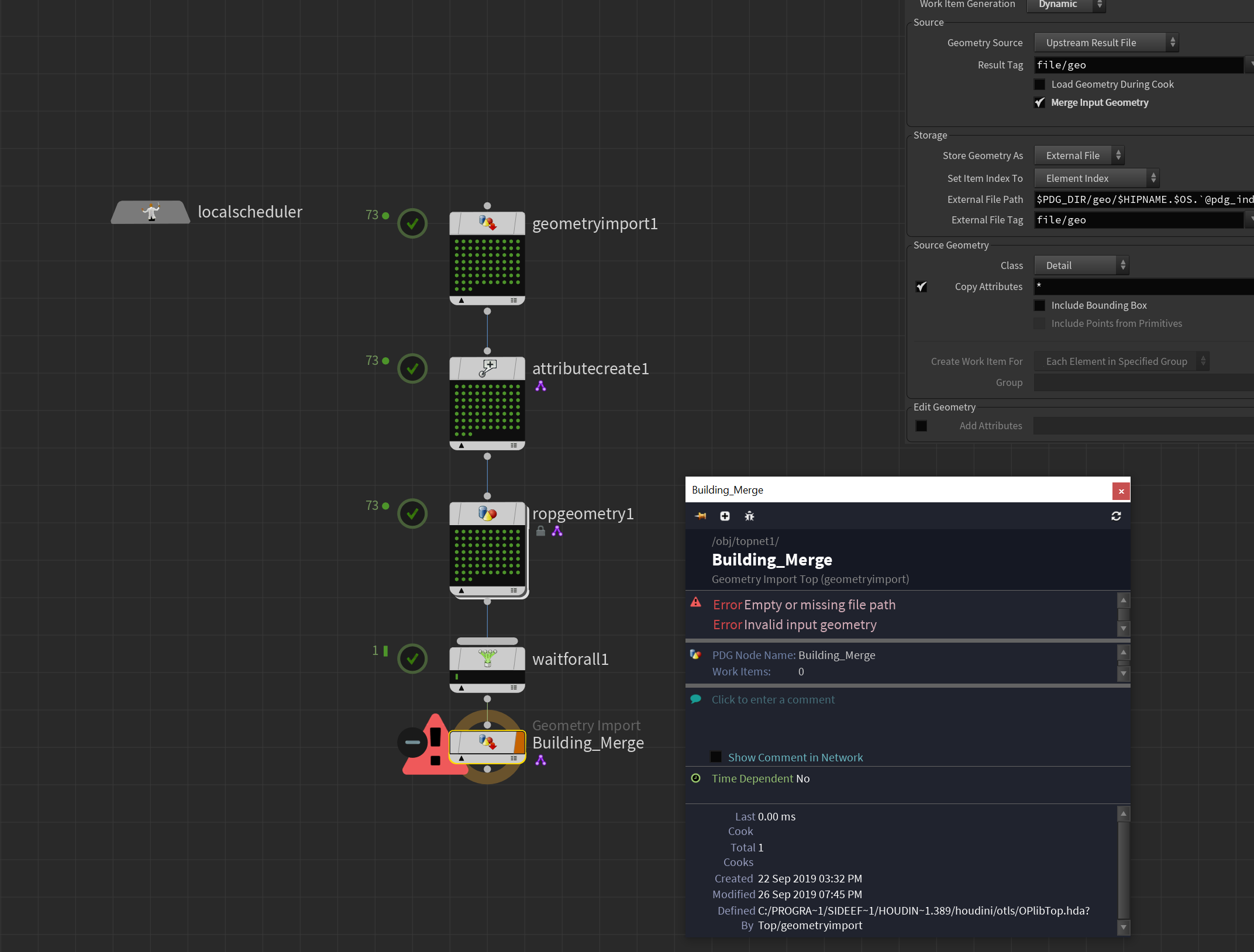

Hello, I'm doing the https://www.sidefx.com/tutorials/create-a-task-workflow-to-build-cities/ [www.sidefx.com] tutorial and I have a problem in the part05 section 2. In the “geometry import” node, I have the following errors.
I've redone every steps multiple times and still get the same errors.
Thank you

Could you please attach a screenshot of the work item attributes? You can access this by CTRL+MMB clicking the work item in the Wait for All node.

Are there any file paths in that window?
Joined: Sept. 2018
Sorry but I'm not sure what you mean. There is nothing more at the bottom of the window, if this what you mean !
