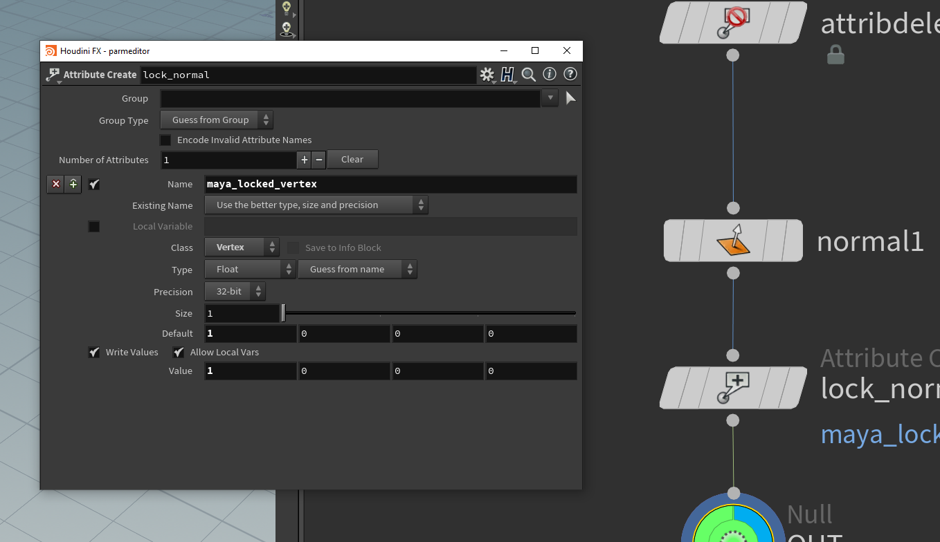

The easiest way to do this is to lock all the normals coming out of Houdini in Maya.
In your hda, add an integer vertex attribute called maya_locked_vertex*, and set all the values to 1.
OOPs - that should be “maya_locked_normal” not “maya_locked_vertex*
Then on the asset node itself, turn on preserveMeshLockedNormal, and turn off preserveMeshHardEdges.
This does have the overhead of needing memory for all the locked vertex-face normals on the Maya side.
Alternatively, if the normals should just be the face normals across the hard edges, you don't need to lock the normals, you can figure out which edges should be hard in you hda, and put them in an edge group called ”maya_hard_edge“. and then use the ConvertMayaHardEdgeToAttribute tool from the HoudiniEngine shelf (on the Games Desktop), to create and set the ”maya_hard_edge" vertex attribute, and turn ON preserveMeshHardEdges on the assetNode. But it's up to the hda to decide which are edges are hard, so that's more work for you.
