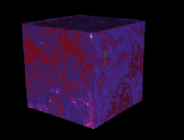

I've been trying a bit more with Redshift and it seems like I'm getting closer, I don't know if there is some gamma mismatch regarding how should be configured the texture samplers of the redshift vopnet, and I also have to resolve some problem with the roughness I guess…
The “auto-refresh” of the textures gets a bit messy when using redshift, it's not easy to get all the cops working in the viewport.
And if you update the Labs tools, it seems like also heps to start with a fresh new project, I tried to load again the SOP Substance material in the project from yesterday and I couldn't get the textures loading properly.
Here is the progress:

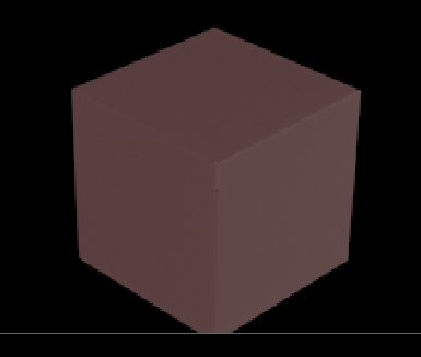

This is, unfortunately, the closest I can get to getting it working for me.
I checked to make sure the Substance file was good by putting it into Unity and it looked good, so I must be missing something. I have been trying to find tutorial videos or even images of working setups that I can try to compare mine to using this SOP, but I am coming up empty-handed as to how to properly set it up if I am not doing it right.

I've been trying to do some simple tests writing out a sbsar file from substance designer to houdini.
I think it's working in mantra, karma viewport but I'm getting missing texture error in karma when I render to mplay.
When I saved the .sbsar file I tried saving the correct channel names, and I also tried copy shufflying them in a cop2Network.
Is this a common issue?
As an example, I've attached the renders from Mantra/KarmaInteractiveViewport/Karma Rendering to mplay
Cheers
Chris
