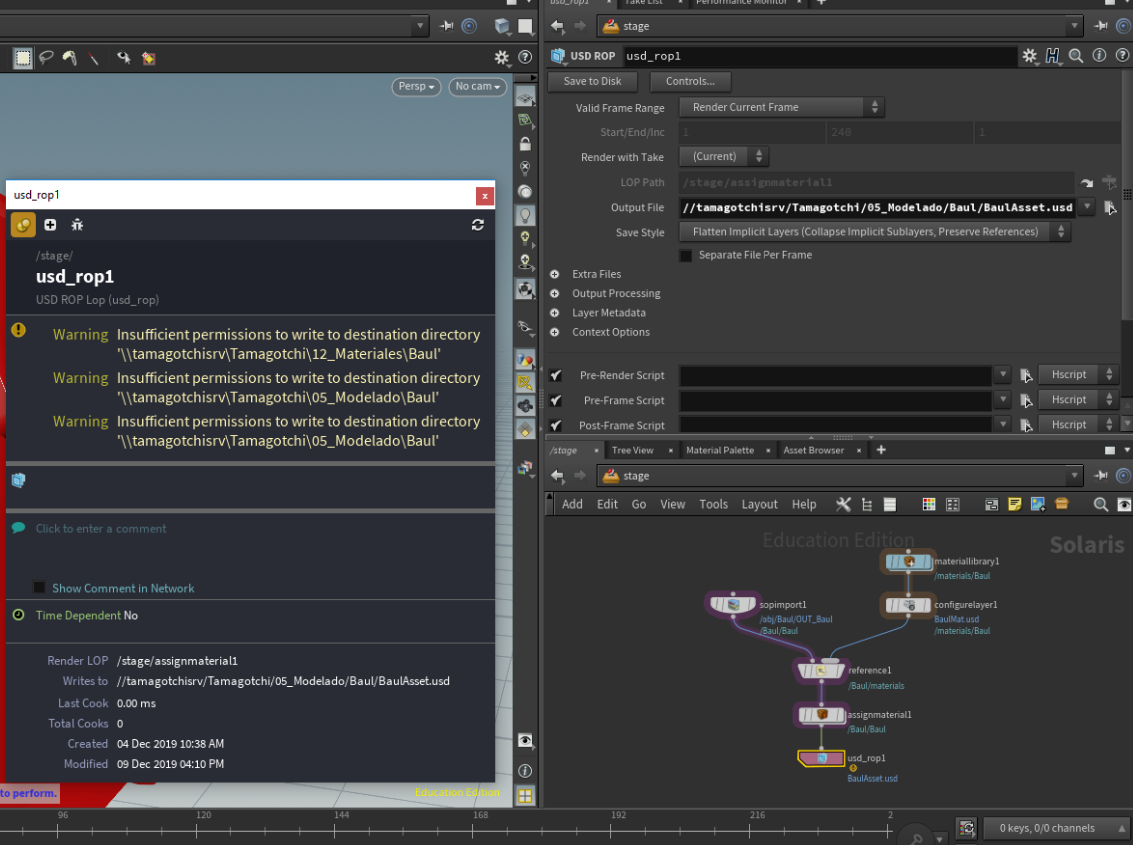

Hi, we are having an issue exporting usd files to a network drive, we get this warning “Insufficient permissions to write to destination directory” It´s not a sharing problem as we are writing files to that drive without problems. We are using UNC paths, so it´s not a mapped drive problem either. Any ideas?

There was a bug reported here (and later moved to the usd-interest google group) about USD having a problem writing files to SMB shared network drives. AFAIK that issue is still unresolved, though some users have been using SMB with USD without issues, so the theory is that there is some configuration of SMB in combination with USD that is problematic. We have not been able to reproduce this problem internally.

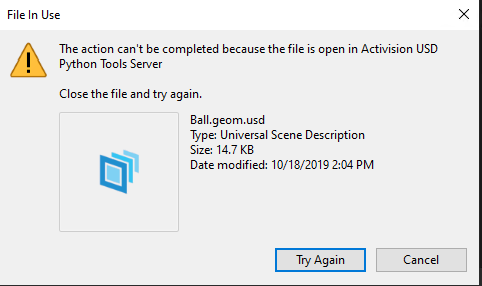

Same issue here.
H18.5.532
Windows 10.0.19042 Build 19042
Steps to repro:
1. Map network drive in Windows Explorer. For example drive E: to network location Y:
2. Write USD to Y:/test.usd
3. Load USD in Stage via Sublayer
4. Try to write to the same location from step 2 (overwrite)
5. Try to delete file from step 2
Both steps 4 and 5 will fail, saying that USD is loaded by Houdini.
If I write and load from drive E:, that is not a network drive, steps 4 and 5 finish successfully.
Hope you can repro this.

The only mystery to me here is that steps 4 and 5 work when you're working on a local drive. As long as a binary USD file is loaded by Houdini, the USD library will have that file locked on Windows.
