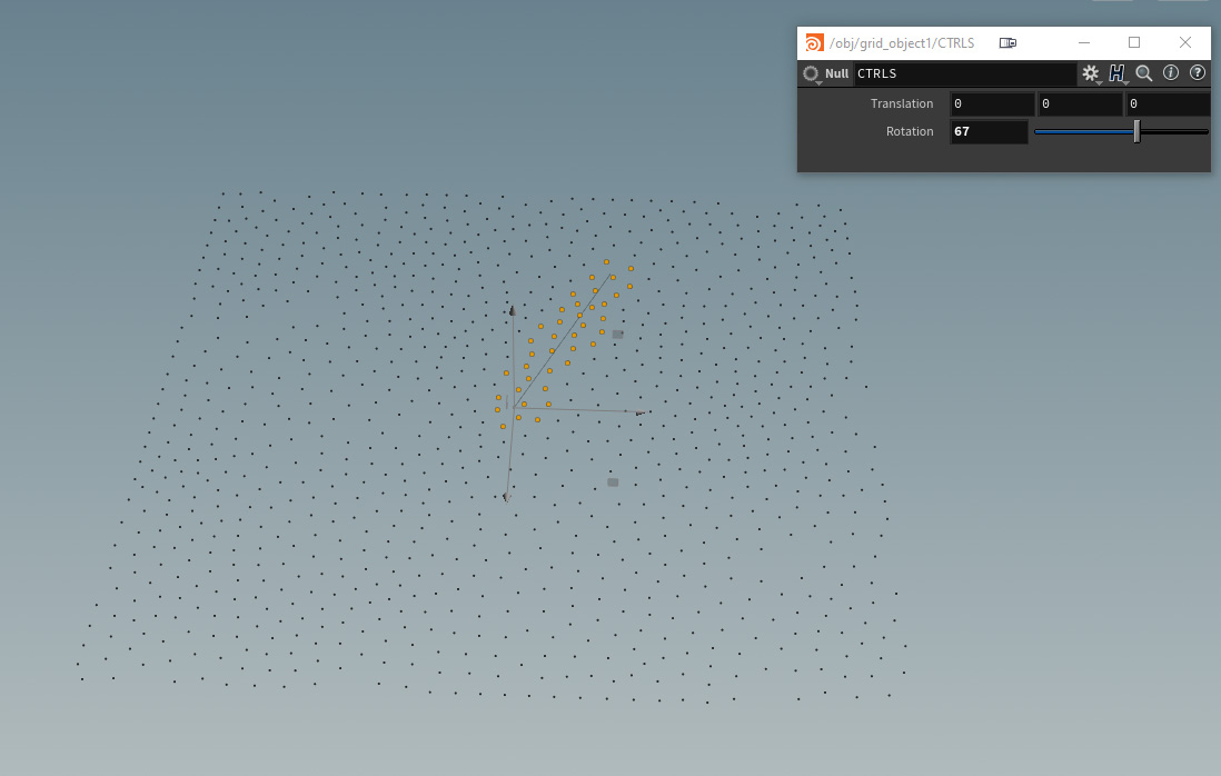

I am trying to used pcsegment that is new VEX function from h18.
https://www.sidefx.com/docs/houdini/vex/functions/pcsegment.html [www.sidefx.com]
int [] pcsegment(<geometry>geometry, string PChannel, vector P0, vector P1, float max_distance, int maxpoints)
I thought it just collects points around the line between P0 and P1 vectors but the most of the case, it collects points only around either P0 or P1. I found it works expectedly only when the angle between vector ((0,0,0) to P0) and vector (P0 to P1) is close to 90 degrees.
I am just curious if it is the correct behavior or bug.
h18.0.287. Linux Mint.
Thanks,
Ryoji

555 posts
the result can be spasmodic when the line in question is far enough away from Origin.
Here's a file to illustrate the bug. Angle can be anything, it works fine…but if the line is
translated away from Origin far enough, result is unpredictable.
I have reported this bug to SESI.
vu_pcsegment_bug.hiplc (93.6 KB)
555 posts
yes !!!…workaround. Line does not have to be anywhere near Origin.
But it would be nice if SESI would fix the vex function itself.
vu_pcsegment_workaround.hiplc (110.0 KB)
555 posts
yes yes yes…..multi segs.
vu_pcsegment_workaround_multisegs.hiplc (117.4 KB)
6413 posts
An embarrassing bug!
Thank you for isolating & reporting this.
Hopefully 18.0.339 will work for you without the need for workarounds.
