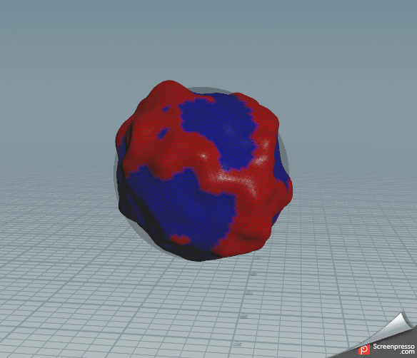

PS: I was trying to color the valley and mountains based on the mountain sop displacement . see image
