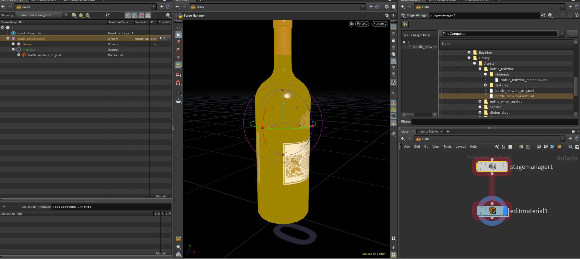

Is there any way to reedit the material of a premade usd file. If the mesh is usd and the material is usd, what I want to to be able to dive back inside the material to make further edits. Or am I thinking about this wrong. Should I think of a usd material as “compiled”. Best Mark

Hi all. Just wondering if there were any updates for this or planned for 18.5? The edit material node also seems to struggle on Shader Nodes created for other render delegates (In particular the HdCycles render delegate). Happy to provide some examples if needed.
Thanks for any insight,

What do you guys mean with ‘complex networks’ btw?
When I import a material it just imports the network? i.e. All the shaders in the material with the connections are there still in tact. (My 3Delight material network)
What's the difference between this network and a ‘complex network’?
Edited by OdFotan - Sept. 23, 2020 12:25:45
- rafal
- 1454 posts
The USD material may have been translated from a Subnet VOP or maybe from a bunch of VOP nodes feeding into the Collect VOP directly inside the Material Library LOP. Both USD translations will look the same, so re-creating the exact VOP network is not possible.
Also, Subnet VOP may have nested Subnet VOPs, which yield NodeGraph prims, and Edit Material does not handle that yet, IIRC.
Even if it did handle NodeGraphs, it's possible a given NodeGraph may have been translated from an HDA VOP, but there is no way of knowing it at the moment, so Edit Material may create a regular Subnet VOP.
Also, the 3Delight material network may be packaged together in with Karma and RenderMan's materials, etc.
When USD shader is a VEX shader translated from a Material Builder, then it's not possible to re-create VEX building block VOPs inside it, unless we encode the VOP network topology in USD.
Anyway, these are the “complexities” that come to my mind off hand.
