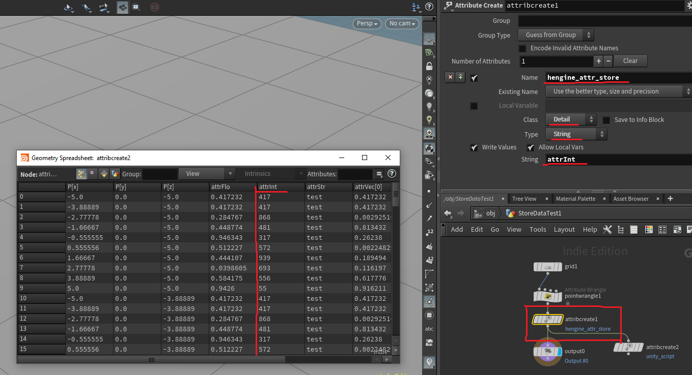

Hi, I'm following this: https://www.sidefx.com/docs/unity/_attributes.html#AttributesStore [www.sidefx.com] documentation to transfer some integer attributes to Unity, but no data arrives in Unity.
I have tried multiple different attributes and tried to replicate the version in the documentation 1:1, but I can't get it to work.
What am I missing? Can anyone confirm this working or maybe provide a working example file?

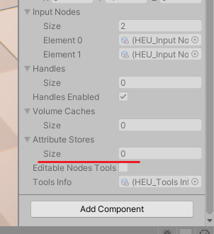

I tried out your hda. There should be an HEU_OutputAttributesStore component on the generated GameObject. This is different from the internal AttributesStore that the plugin uses for paint and editable nodes. See the screenshot.

Hi Seelan,
I do have this component, but it does not seem to contain any data at all (see attached image).
