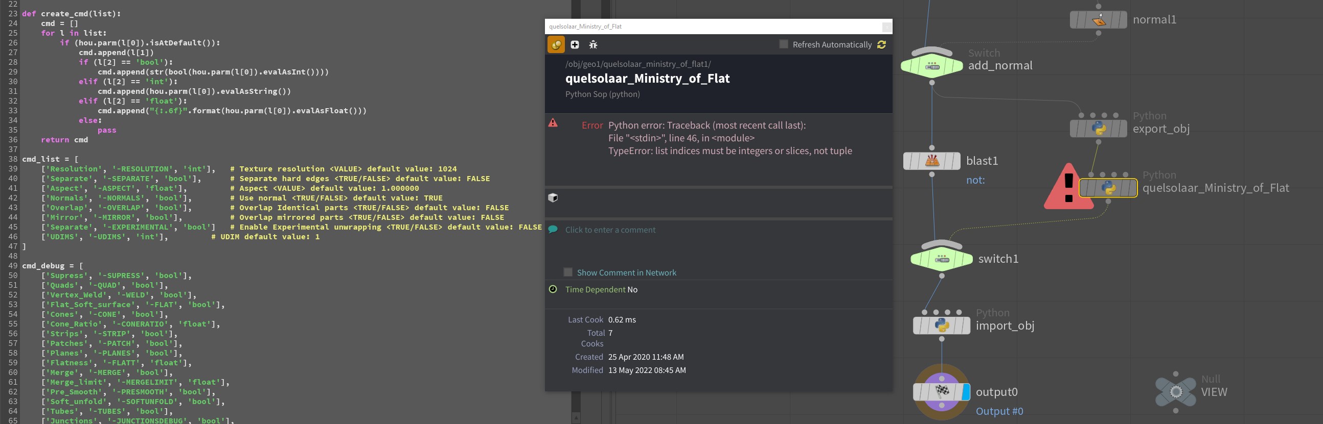

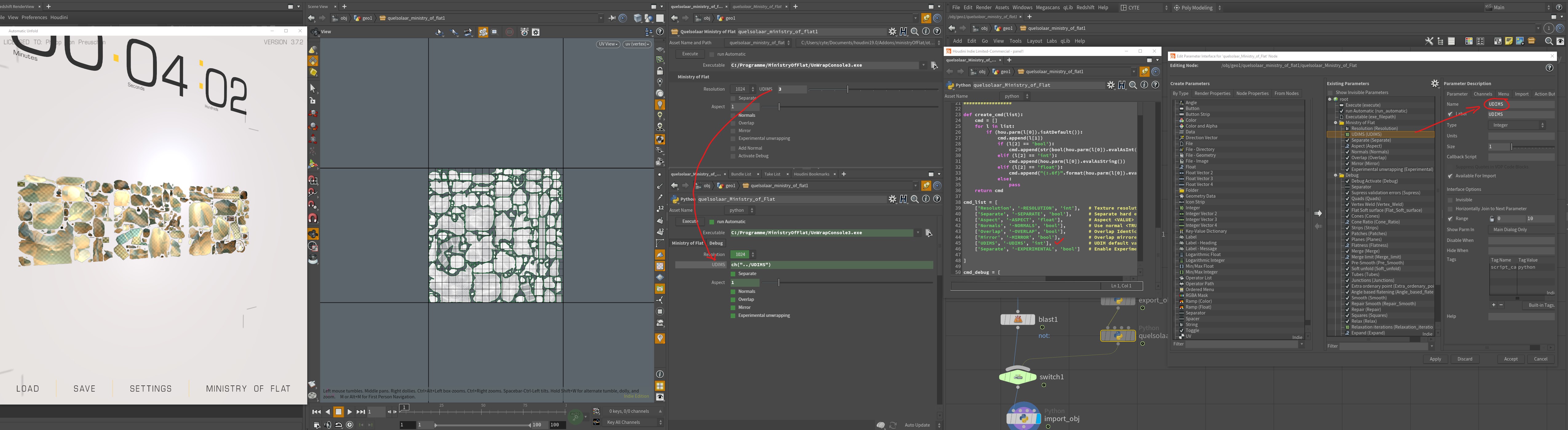

Hey mandrake0,
thank you very much. Please take a look at this:
(Ministry of flat is version 3.7.2 for me)
Edited by CYTE - May 13, 2022 03:41:54
Screenshot 2022-05-13 084637.jpg (267.7 KB)
Screenshot 2022-05-13 093948.jpg (932.7 KB)
644 posts
Joined: June 2006
The Python Node quelsoolar_ministry_of_flat the python code needs to be replaced.
I added also a command output option.
a new toggle parameter with the name "DebugOutput" needs also to be added.
test_UVUnwarp.hipnc (288.8 KB)

Hey mandrake0,
I implemented the changes you suggested. And here is the hda with working UDIM support. Thanks a ton!
Cheers
