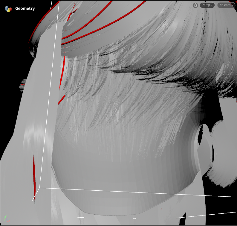

Joined: April 2022
iam having this issue while generating hairs the guides are above the head then also my hair gen is generating hair inside the head here are some attachment
