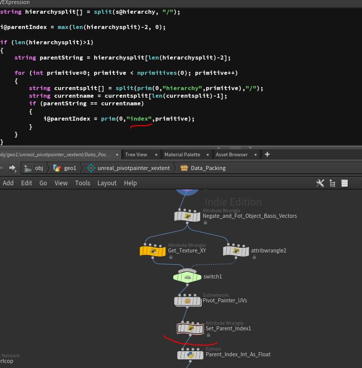

I went through your youtube tutorial and was then trying to get a MAT with the PivotPainter2FoliageShader MF to work (the one that does the wind effect) but it doesn't seem to work as intended right now.
I think I've narrowed it down to the parentIndex not being correct, looking at the Set_Parent_Index attribute wrangle, I see :
i@parentIndex = max(len(hierarchysplit)-2, 0);
This seems to point to the parent hierarchy level but not the actual parent index?
for numberOfStepsFromRoot you have i@numberOfStepsFromRoot = max(len(hierarchysplit)-1,0); which is pretty close and makes sense.
I'll try to dive a bit deeper, but let me know what you think!
Thank you!
edit : a minor comment : it would be great if pivotpainter1 was not templated be default inside, since the layout lightmap uvs is on and the flatten uv operation is pretty slow! (I also noticed you still had the PP2 placeholder inside PP1 )
edit2 : for other that have issues, with PP2 I had to uncheck generate lightmap UVs in Unreal which is on by default, otherwise it overwrites the necessary UVs created by the HDA.
Edited by vinz - Feb. 7, 2021 15:49:45

Joined: Feb. 2019
Yes, the parent index is wrong.
Changing the Set_Parent_Index AttributeWrangle to something along these lines:
string hierarchysplit[] = split(s@hierarchy, "/");
if (len(hierarchysplit)>1)
    string parentString = hierarchysplit[len(hierarchysplit)-2];
    for (int primitive=0; primitive < nprimitives(0); primitive++)
        string currentsplit[] = split(prim(0,"hierarchy",primitive),"/");
        string currentname = currentsplit[len(currentsplit)-1];
        if (parentString == currentname)
            i@parentIndex = prim(0,"selectionIndex",primitive);
f@random01Value = rand(random_shash(s@hierarchy));
should fix it.
113 posts
Joined: Dec. 2007
DodgeRollBrent
Thank you, that was helpful! finally had time to dig more into it, and the other change that was needed was to use the "index" attribute that's created further down (and so have the wrangle further down), and it now appears to work as expected, but will do more testing.
Edited by vinz - April 9, 2021 10:57:56
197 posts
Joined: July 2015
Hi, thanks for reporting these issues. I have verified and fixed them.
If you update Labs, drop down a NEW instance of PivotPainter you will have the improvements.
Additionally you can now provide an up vector, which the tool will use when encoding the information, rather than trying to derive it automatically. If no up is found on the pivot points, it will fall back to old behavior.
You can now also customize the range used for encoding. Previously this was hardcoded to 2048 (like in 3dsmax), but this has now been made a variable you can tweak. Lowering this number will give you far superior precision, and this change is coming to the max plugin soon too.
