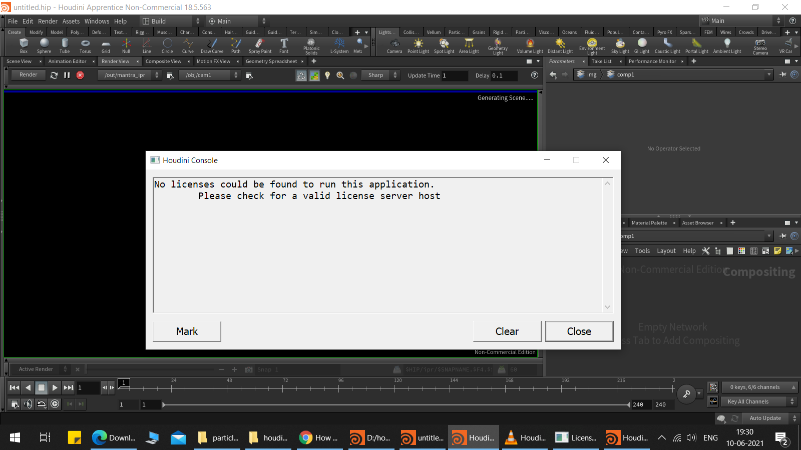

9 posts
Joined: April 2020
I am also facing the same problem @HappehLemons. can you please tell me how can I add license again manually in apprentice license
Edited by ShubhamRai - June 10, 2021 10:20:52
Screenshot (330).png (205.7 KB)
