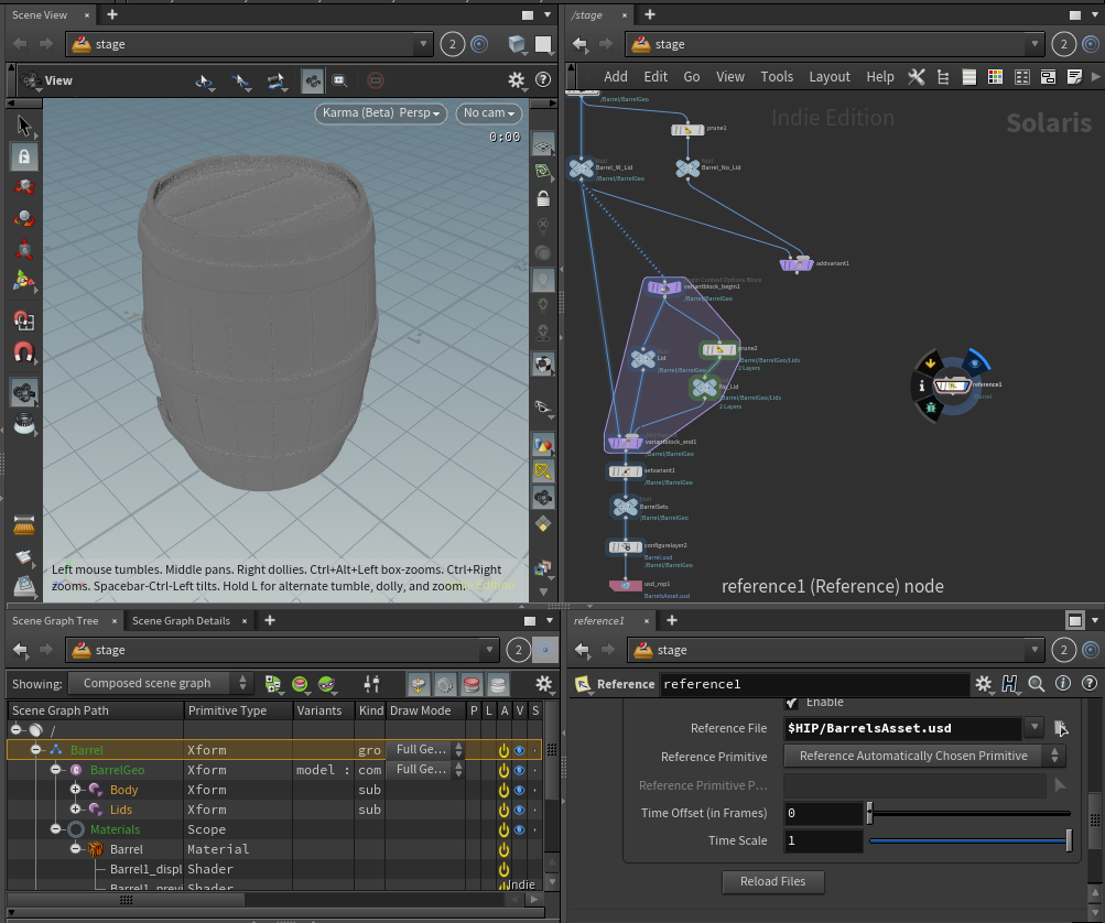

I was studying Solaris workshop, and I downloaded the assets from the documentation’s link
In my original Houdini file, I can see and render the UDIM files in LOPs,
but it does not appear when i load the USD reference file back
i tried jeff Wagner expression “from his workshop”:
$HIP/Textures/repacked_BarrelWithLid/repacked_BarrelWithLid_UV_%(UDIM)d_BaseColor.png
it does not appear when i load the USD reference file back.
i tried the documentation expression https://www.sidefx.com/docs/houdini/solaris/tutorial_1.html#matlib [www.sidefx.com]
$HIP/Textures/repacked_BarrelWithLid/repacked_BarrelWithLid_UV_<UDIM>_BaseColor.png
also it does not appear.
the only way makes it work, is to map the UDIM number itself “ 1001 ”
$HIP/Textures/repacked_BarrelWithLid/repacked_BarrelWithLid_UV_1001_BaseColor.png
then it will show up in the USD reference file, but definitely it will not read the other UDIM files.
I hope you can help me find the solution

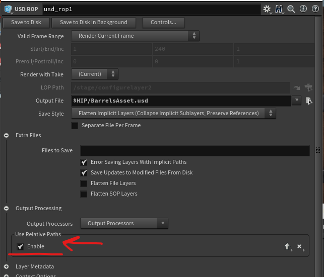

Joined: Aug. 2013
ok … i found the issue
by default .. the USD ROP has an option in the output processing … called use relative path
this option makes the material USD file look like this
which makes the USD reference file render like this
but when i remove the option of “use relative path” the material USD file uses the full path of the textures
and the render read the UDIM normally

Joined: Aug. 2013
when i put the material USD in the root folder (beside the hip file) the relative path became “ @/. ” because textures filer is beside material.usda
but when i save material.usda inside Materials folder .. the relative path will be “ @../ ” because the textures folder up one level from material.usda
Joined: Aug. 2013
i think what is happening with me is … if the path is relative path, the UDIM concatenation it can not be resolved … thats why when i write one patch number manually “like 1001” .. it can read the file “while its relative” and render it normally.
or .. if i make the path as absolute path, then the UDIM concatenation will work normally
4525 posts
Oh, sorry, there was an accidental backport of a change from the next Houdini version back to Houdini 18… Thanks for pointing this out. I'll fix this in the next couple of days (18.0.580 or 18.0.581).
