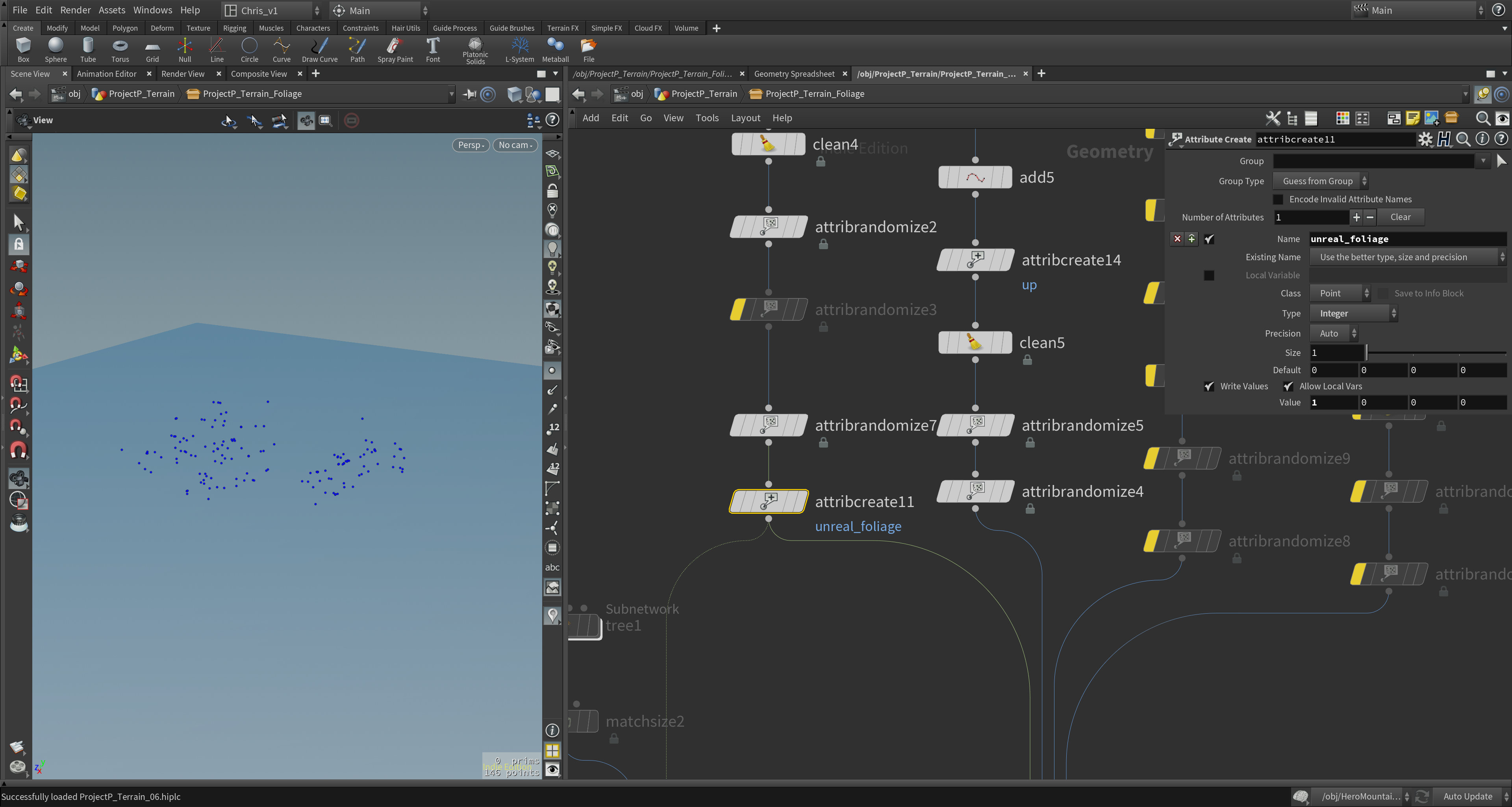

I tried doing this but compared to Simon Houdinis presentation the little checkbox is missing in my HDA.
My Setup is …
1. Attribute Create with the static mesh string from Unreal (works)
2. Another Attribute Create node below with “unreal_foliage” as an Integer.
Do I need to add a special tag to the HDA? What am I doing wrong ?
My Setup is …

ChrisGG
My Setup is …
From what I understand you need unreal_instance as well
Houdini Technical Artist @ Sharkmob
