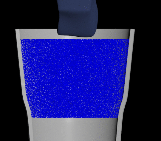

I think I have a similar problem so I will post it here. I can't find solution for volume loss in flip after introducing rbd object. I've tried everything, I knew that could help but with no luck. I'm attaching hip file, so maybe someone has some time to look at this, and push me in right direction.

Hi Orsonorix, I'm facing same issue. Were you able to solve the problem?

I can't run my computer now.
In DOP exists gas node for preserving volume.
Something like Gas Equalize Volume.
Fluid solver has two ... "things".
He add points where particle amount too small, and remove particles which stack into another particle.
Read "Reseeding" and "Separation" in fluid solver documentation
