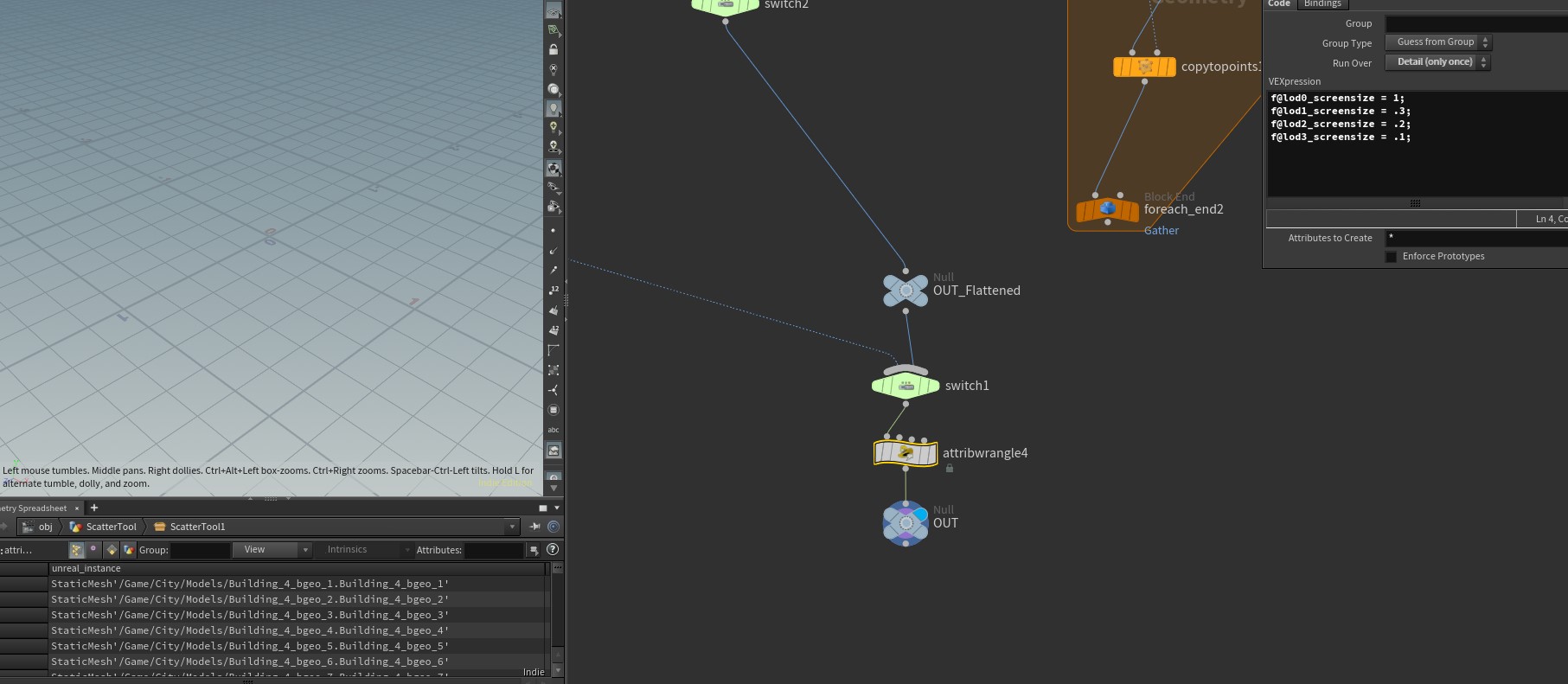

can you elaborate on that one.
If I am object instancing Unreal objects, do I put this in to detail attribute on points. ( tried this didn`t work attached image , maybe i misintrepret the docs)
Screenshot 2020-11-19 013701.jpg (173.5 KB)
