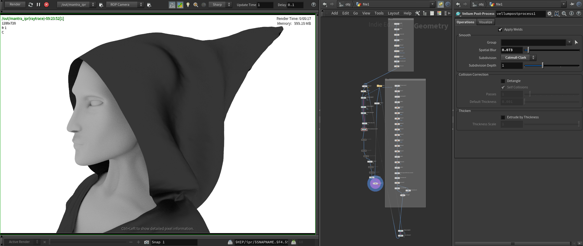

Ohh, I figured it out. There are two nodes, Planar Patch and Planar Patch from Curves, that give you specific point counts along edges. Fantastic! That makes the Houdini Draw Curve node somewhat bearable, but I tried going the Illustrator > Maya > Houdini route and that works great too.
Edited to add a proof of concept. Some refinements need to be made but overall the process is pretty manageable. Planar Patch is a lifesaver. Certainly not quite as easy as MD, but being able to go in with the Vellum Brush afterwards is awfully nice.
