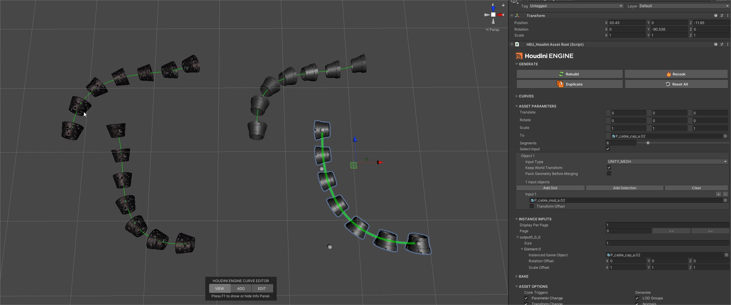

I want to populate a curve with instanced meshes. Simple with orientation along curve & copy to point.
I keep only points of my curve. N, up & orient attributes are on points.
Inside unity, I edit my curve, I can move & rotate it, no issue. But when I replace points using unity_intance, if I rotate my curve instance lost or not update N or orient.
Can you tell me what I miss, or if I make mistake somewhere?

To test, I start from a box, extract one prim, use a copy to point & create points by VEX.
Something should be wrong or missing when I create those points because when I use them as the input of copy to point I don't have the same result.
I'm pretty sure that it's not so complex to keep all information from the curve's points and keep them up to date after transforms on Unity?
