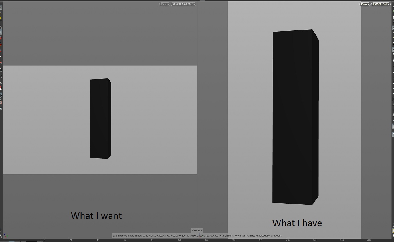

I do some projects where it is originally made at a 9 x 16 aspect ratio. Later down the road I need to make a 16 x 9 aspect ratio version of the spot. I use the same camera, but rotate my comp for the front, but when the product is revealed at the end, I cannot use the same camera to keep the composition.
This hasn't been a problem because I had been doing the product in Maya up till now. Under the camera properties in Maya, under Film Back, there is a drop down called "Fit resolution gate". If I change it to "Vertical" and flip my cameras aspect ratio, it will keep the same framing of the product (just wider now/more revealed on the sides), and I am able to use one render for two spots. I can not find any option like that in Houdini.
I hope this made sense, I appreciate you taking time to read and help if you can. Thanks.
Edit: I think I was able to get it to work through exporting it to Maya and re importing it as an fbx. Here is a visual of what I mean
Changing Camera resolution but keep the same resolution gate
