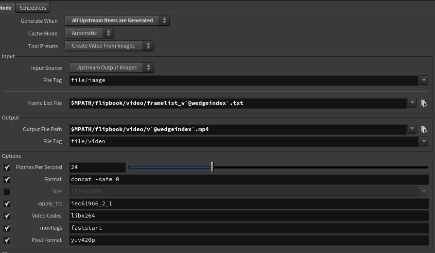

I am trying to find the way to create videos from flipbooks.
For example I have 10 wedges->10 flipbooks -> 10 videos with ffmpeg TOP.
Most closest solution I found using
$MPATH/flipbook/video/framelist_v`@wedgeindex`.txt
$MPATH/flipbook/video/v`@wedgeindex`.mp4
this one creates 10 lists and 10 mp4 but all mp4 files are broken.
600 posts
Joined: May 2014
Are you able to attach a .hip file with your current setup? You'll need to use a partitioner before the FFMPEG node in order to group all of the frames from the same wedge index together. For example, using either a Partition by Attribute using the "wedgeindex" attribute, or a Wait for All with the "Split by Attribute" field set to "wedgeindex".

Thanks tpetrick, it works.
I am posting file in case somebody needed solution.
