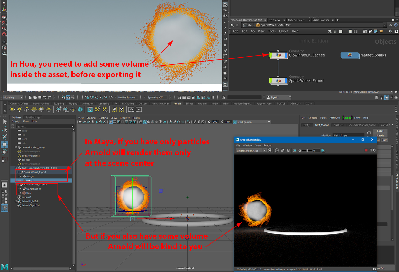

Ok I finally found a solution that works!!
First some information:
¤ The problem is not related to Maya 2020 and its Arnold version. The same behavior occurs in Maya 2020 and Maya 2022.
¤ In Houdini, While creating an asset, it is NOT necessary to add a Transform node, as I did in the picture "Move particles in Maya" above.
¤ In Maya, after importing the asset, it is NOT necessary to create a rig-like object and to add expressions to the asset’s channels, as I did in the picture "Move particles in Maya" above.
¤ motion blur and keyframes are NOT involved.
I've done a lot of testing and finally got a Houdini Particle asset that worked: when I was moving it away form the scene center, Arnold rendered it properly, even with motion blur and keyframes. But in my asset, the particles were not alone, there were also 2 VDB volumes, appearing as fluids in Maya. When I imported another asset in another Maya scene, the same problem came back, because this asset was containing ONLY particles and no Houdini volume / Maya fluid. So the solution is a bit weird, but here is what I should do, whenever I need to import Houdini particles into Maya via Engine:
In Houdini, I need to include in the asset some VDB Volume, even a light one. It's just a dummy. I beleive it needs to be a volume. I tried to include a second particle system and a cube, but they didn't work for me.
In Maya, import the asset using Engine. It's possible to hide the "Fluid" object. Translate the Asset object away from the center and Arnold-render it: it works!
Enclosed is a pic that summarizes this.
Now what's strange it that the asset I put in my Onedrive only had particles. But still John had no problem with it. So there's still something I miss here…
So I would apreciate if some other people test this : import Particles only , move them away from the scene center, and render them using Arnold… Tell me if this works, thanks!
