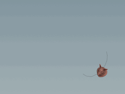

not sure what I'm smoking but thought it was simple ?
vu_AUS.hipnc (252.4 KB)
