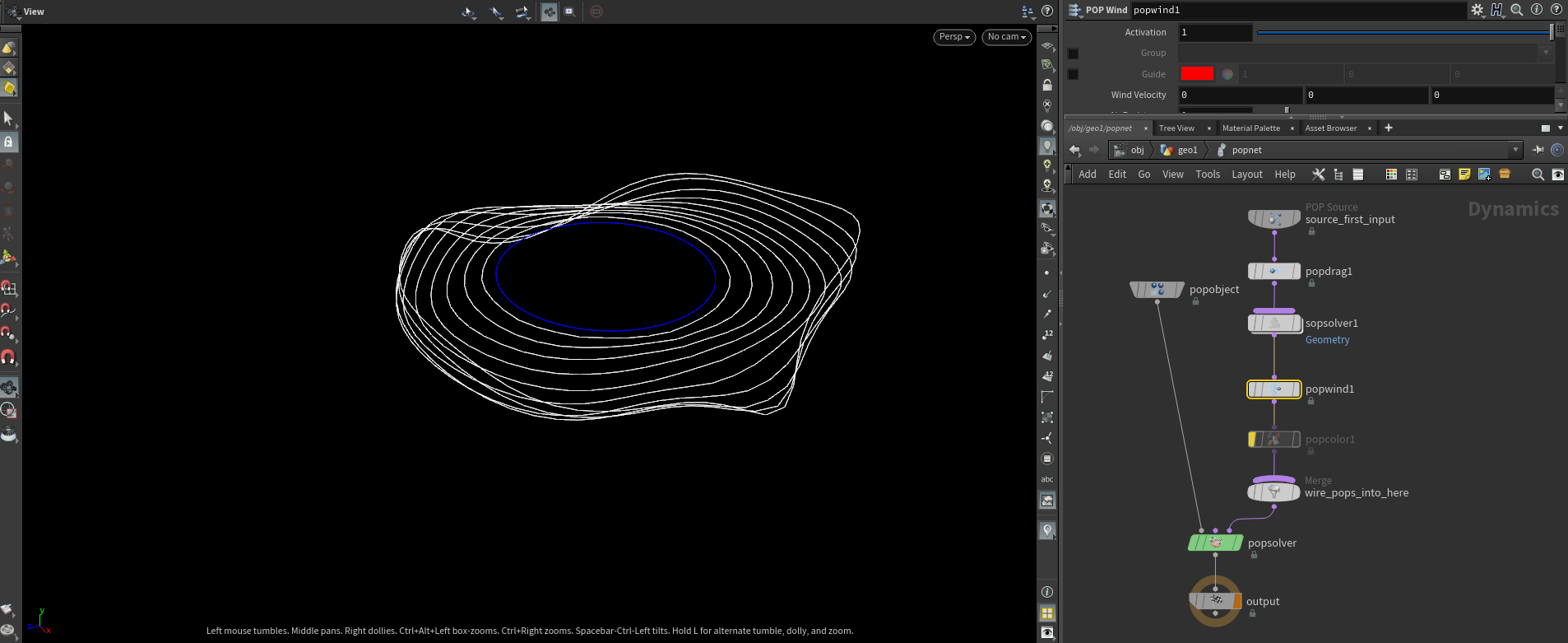

I have a scene where I am emitting circles where a POP wind is creating the noise, but I want to be able to limit it only on the Z and X axis.
How would I achieve this?

Thanks for helping out, thankfully somebody on another forum answered my question. They mentioned to add a pop wrangle after the pop wind, with v@targetv.y=0; seemed to do the trick!
