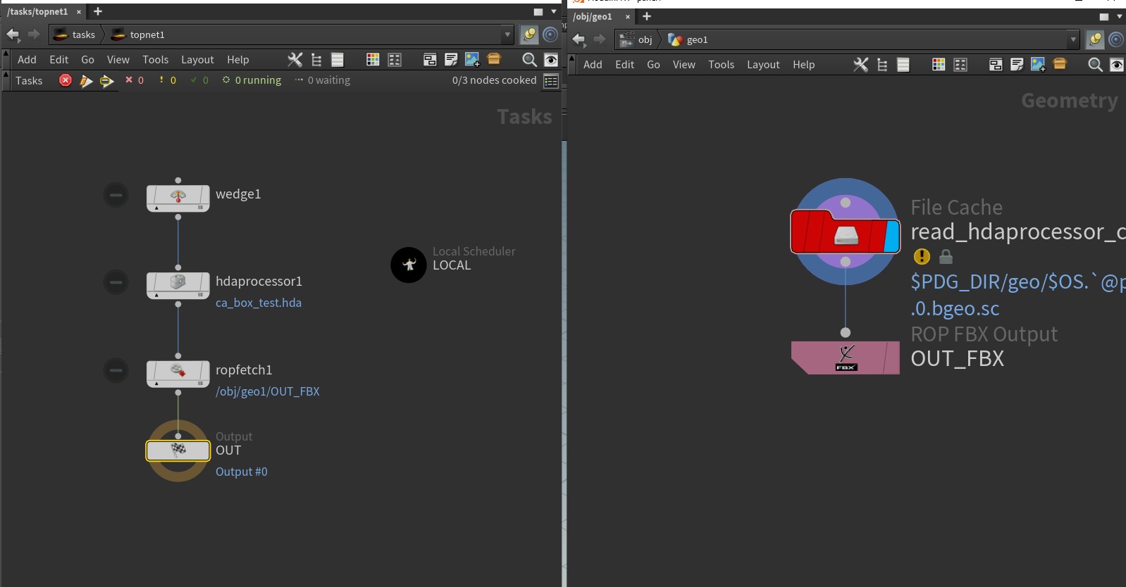

This works splendidly, thank for you taking the time to create the .hip file and everything. The only issue I'm having now and am trying to figure out is how to have the object names transfer as well from my input.
e.g.
in the file `art.fbx` I have a mesh named "art_LOD0", "art_LOD1" when I export from the ROP it names my new objects after the last node in the chain which in my case is "autouv1". I'm still pretty new to houdini so I'm checking if I need a "name" attribute or something like that.

Alright I figured it out. Here's the very simple solution that I'm posting here in case anyone else googles for the answer and can't quite find it.
Problem:
When exporting fbx from ROP FBX node, the model is named whatever the last node in the chain is.
Solution:
In my case, my model has a 'name' attribute which is the correct name for each primitive, toggling the option in "ROP FBX Output" "Build hierarchy from Path Attribute" and setting the "Path Attribute" to 'name' works great.
Here's my setup
Thanks all,
Colin
