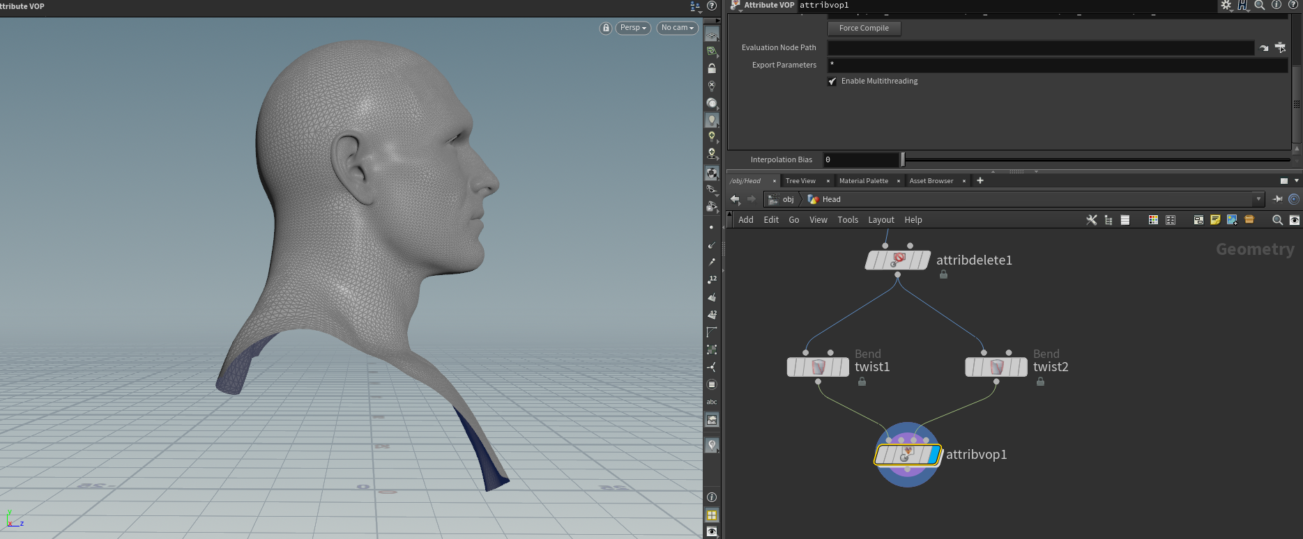

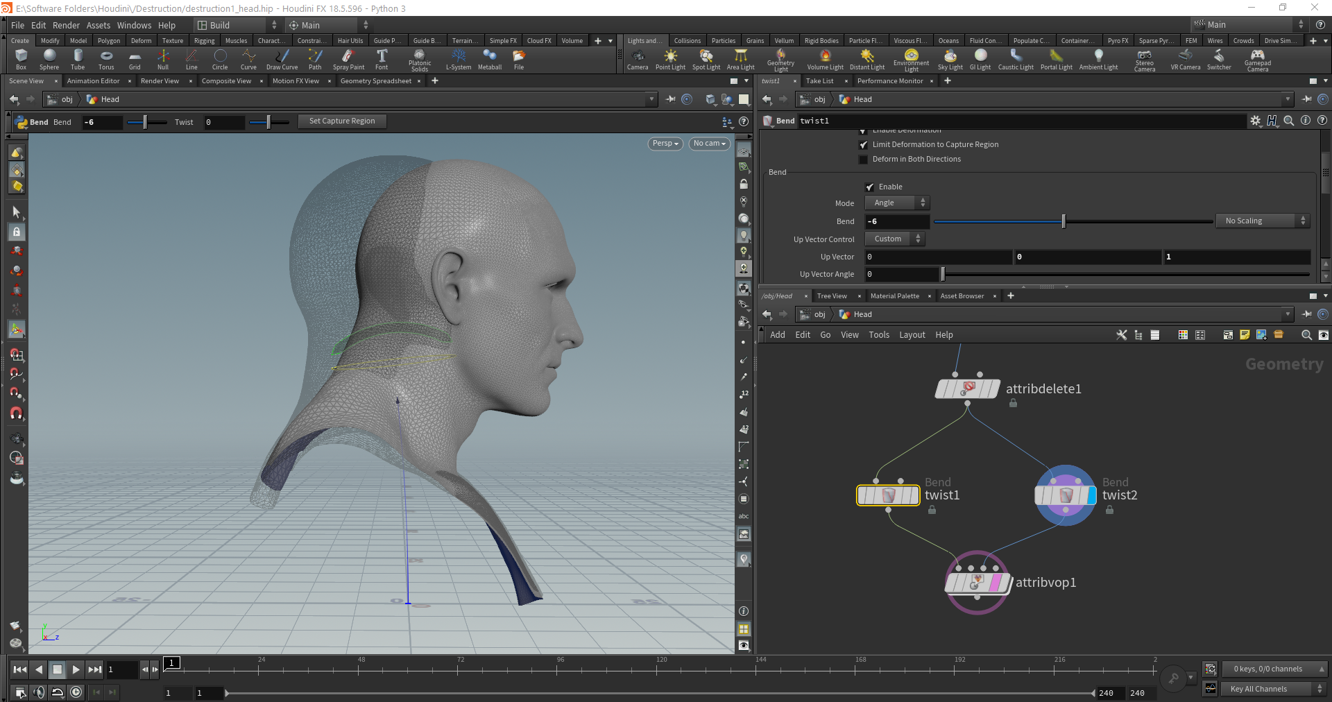

So I have this head bust with 2 blend nodes:
Bend node 1: Bends -6 degrees [i.gyazo.com]
Bend node 2: bends +10 degrees [i.gyazo.com]
After that im trying to simply blend POSITION of those 2 nodes with attribute VOP controlling by the bias.
VOP here [i.gyazo.com]
But for some reason what i get is scaling down...Any help?

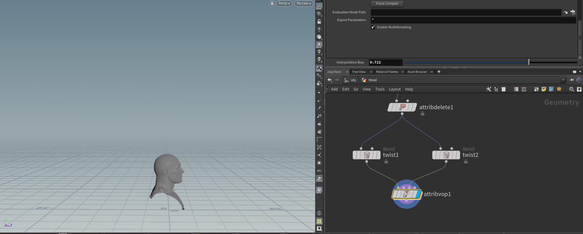

Bias 0 [i.gyazo.com]

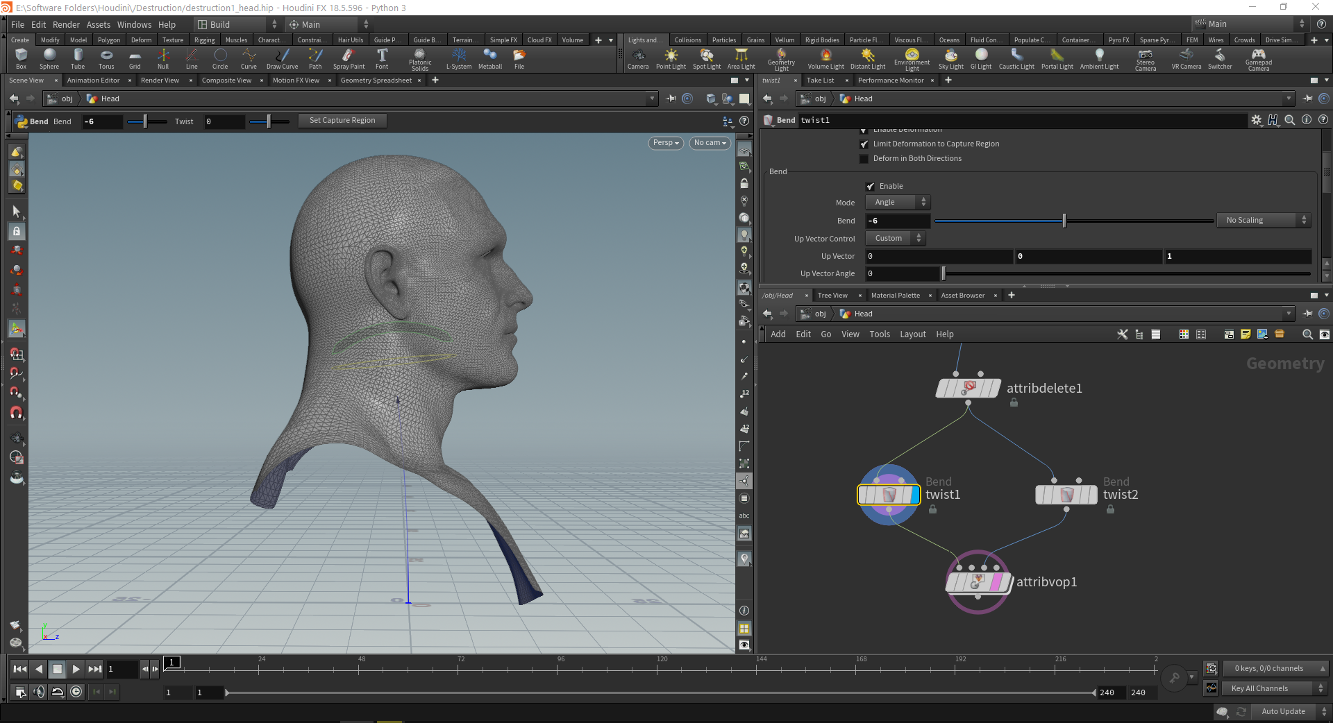

Bias 0.612 [i.gyazo.com]
Houdini attribute VOP blends scale instead of position.
